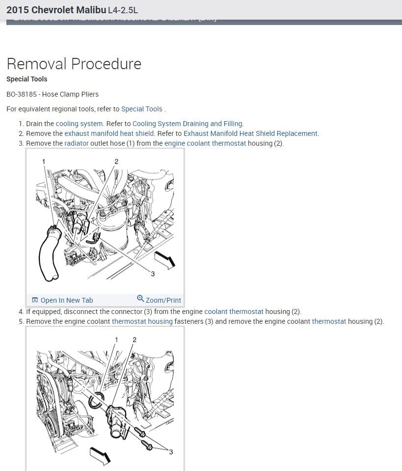

temperature gauge not working properly
2015 CHEVROLET MALIBU
47,500 MILES • 2.5L • 4 CYL • 2WD • AUTOMATIC
MIKEY5358
the temperature gauge only goes up to the mark between 14/ and 1/5 mark.
Oct 19, 2021 at 10:59 AM
MASTER ASE TECH
  • 82 POSTS

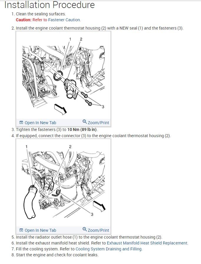

Hi, I'm Dan. Sounds like you could have a thermostat stuck open not allowing the car to come up to temperature. I've attached the procedure for replacing the thermostat, a fairly easy job on this car. Be sure to check the basics like making sure there is enough coolant in the radiator.
