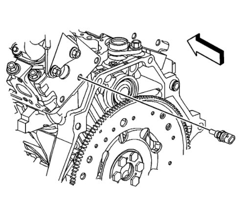

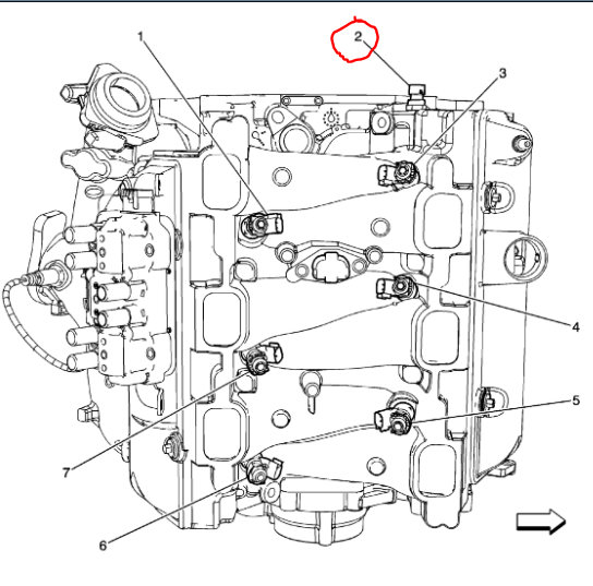

My temperature gauge keeps on fluctuating, it starts in the middle and it almost goes up to the top. Back in May 2020 the water pump, radiator fan and new coolant were all replaced. What could this issue be?

Have you noticed if the car is overheating? Is it running at normal temperature or boiling over? Otherwise it sounds like you might have a faulty coolant temperature sensor. Here is a tutorial showing how a coolant temperature works and symptoms
for you to look at:
https://www.2carpros.com/articles/symptoms-of-a-bad-coolant-temperature-sensor
https://www.2carpros.com/articles/how-a-coolant-temperature-sensor-works

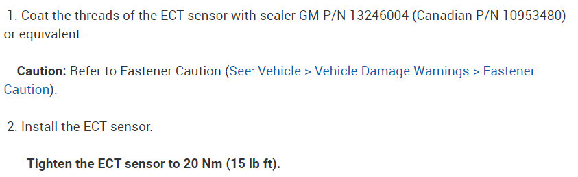

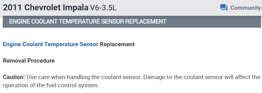

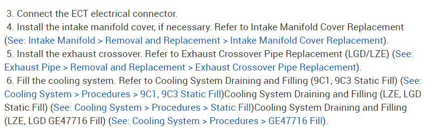

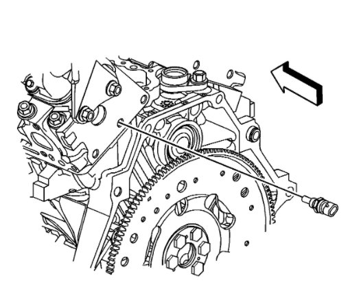

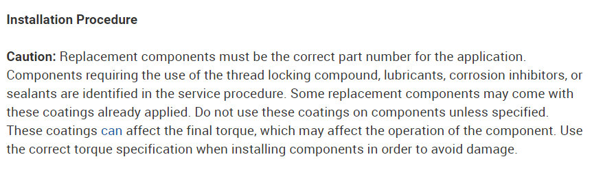

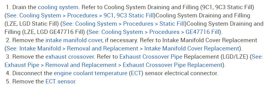

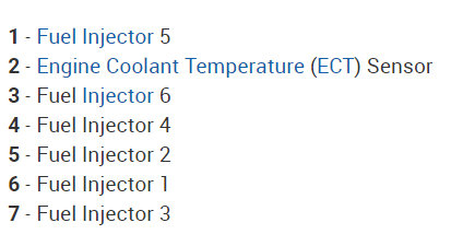

The coolant temperature sensor is located on the back of the engine near firewall in the back of the left cylinder head. I've attached picture steps below on how to replace for your car. It shows the location also. Hope this helps and thanks for using 2CarPros.

My car is not overheating and it's running normal temperature, but it will get to normal temperature then it will get close to the H. I'm going to read more info about your answer. I appreciate it.
