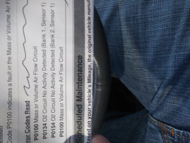

Could any of these 4 codes cause the temperature to fluctuate?
Oct 11, 2019 at 10:27 PM
  • 110,244 POSTS
Welcome back:
With those codes, the engine has to be running in what is called a closed loop. Basically, the computer makes the fuel mixture rich enough for it to run regardless of temp. I would like to say they wouldn't, but if the engine is running hotter due to a richer than normal fuel mixture, it could.
