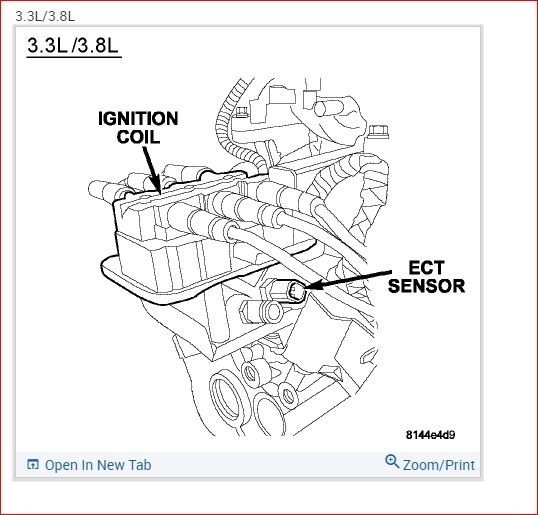

The temperature is fluctuating in my van. it will shoot up like it is overheating and the warning light comes on but before I can even get the car pulled over it will drop back down to almost normal. It does this with and without the A/C running? Is it the thermostat or the coolant sensor that needs replacing?

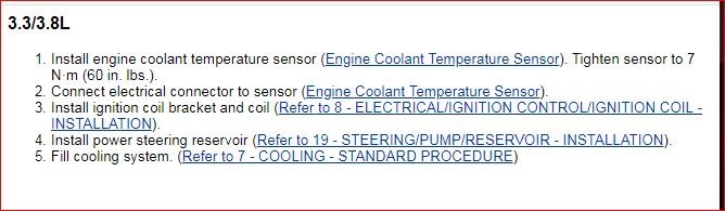

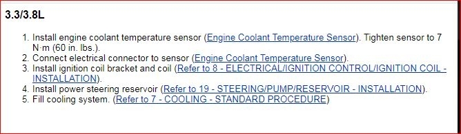

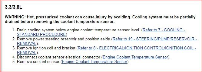

I attached the location of the temperature sensor if you find it needs to be replaced.
