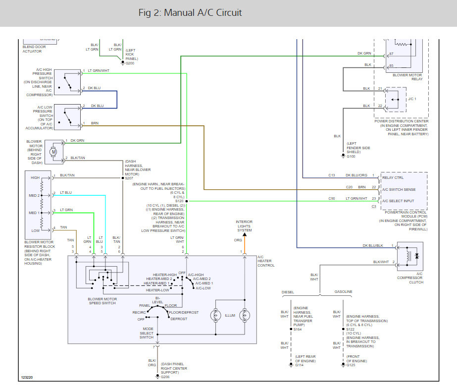

I can’t get the temperature control motor to work
190,000 MILES • 5.9L • 6 CYL • TURBO • 4WD • AUTOMATIC
CHANCE OLSON

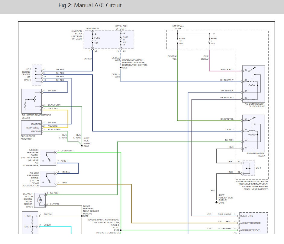

I can’t get the temperature control motor to work. I changed that motor and the HVAC control unit in the dash. One wire has constant power at both ends, but as I move the dial from hot to cold, i never get power at the other two wires. Am I looking at having been sold a faulty control module?
Oct 23, 2019 at 3:12 AM
  • 55,721 POSTS
It is possible but we should check power and grounds before we go any further. here is a guide to help with the HVAC wiring diagrams so you can see which wires to test:
Apr 23, 2021 at 4:45 AM
