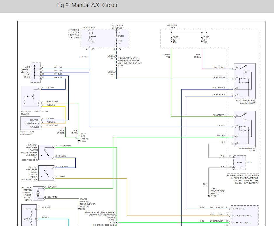

I can’t get the temperature control motor to work. I changed that motor and the HVAC control unit in the dash. One wire has constant power at both ends, but as I move the dial from hot to cold, i never get power at the other two wires. Am I looking at having been sold a faulty control module?

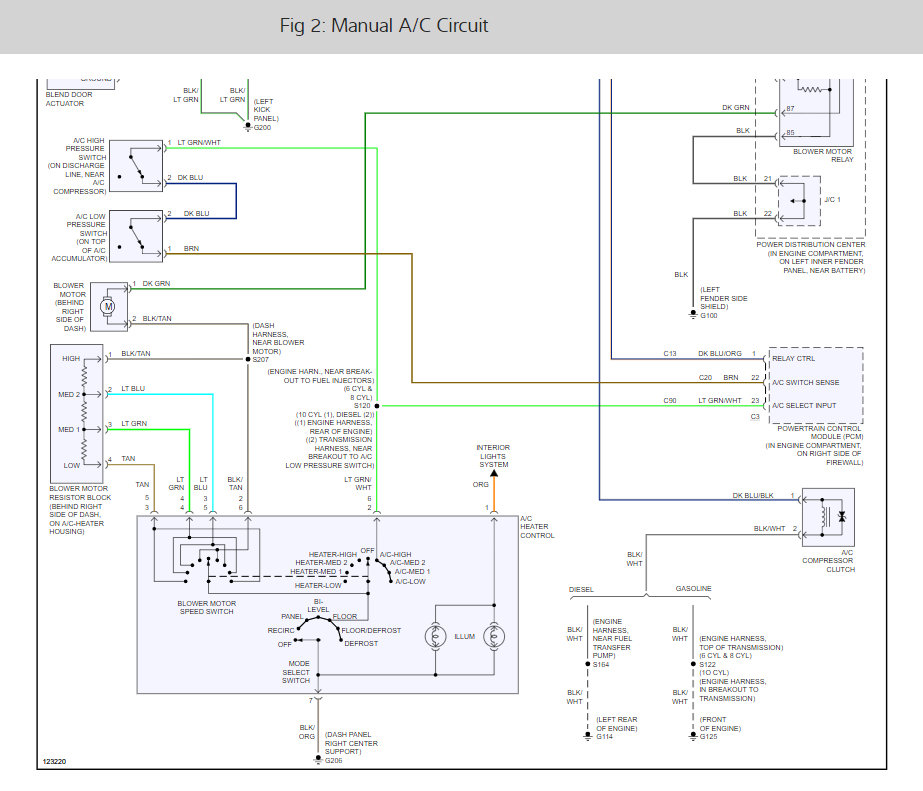

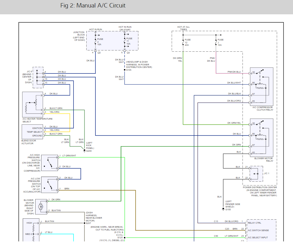

It is possible but we should check power and grounds before we go any further. here is a guide to help with the HVAC wiring diagrams so you can see which wires to test:
