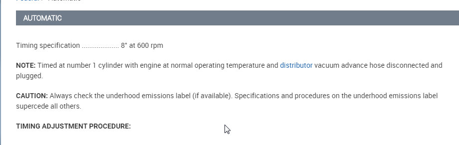

The thermostat is a 190°. During a 3 mile run it pushes up over 220. Is that normal?

220 is a little high. However, it is most likely not overheating at that point so if it stays at 220 then that is okay. Assuming the thermostat is new and working then just make sure your timing is adjusted properly as this will cause the engine to run hot and is commonly overlooked.
Let me know if you have questions and we can go from there. Thanks
