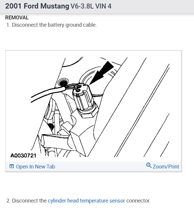

Where is the temperature coolant sensor located?
2001 FORD MUSTANG
165,253 MILES • 3.8L • V6 • 2WD • AUTOMATIC
ESESHADOW1013
Temperature coolant sensor location needed.
Aug 14, 2023 at 9:39 PM
  • 54,832 POSTS

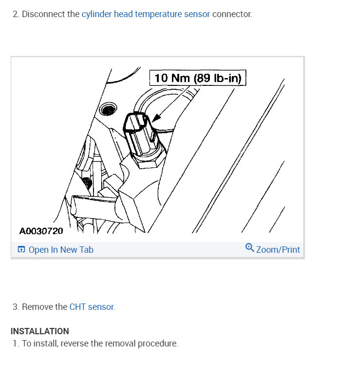

Cylinder Head Temperature (CHT) Sensor
The Cylinder Head Temperature (CHT) Sensor is located on the rear of the left cylinder head.
Check out the images (below). Please let us know if you need anything else to get the problem fixed.
