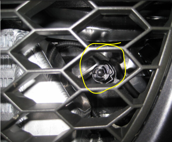

starting my car, the notice is showing _9 degrees. temperature outside is in the 35 degrees. once driving the temperature granulates to the outside temperature.. why is this happening?
Dec 10, 2022 at 4:24 AM
  • 110,244 POSTS

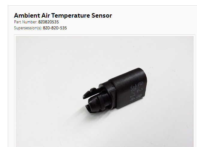

Often times there is a weak connection at a sensor or module. On this vehicle, there is an ambient air temperature sensor that is located behind the lower grill in the front. See pic 1.
Here is what I suggest. Remove the lower grill, 2 screws at top, and inspect the wiring. Make sure the connector is tight, clean, and free of any damage. If it checks good, chances are the sensor is bad.
Pic 2 below shows what I believe the replacement part to be. Just confirm it with the seller.
