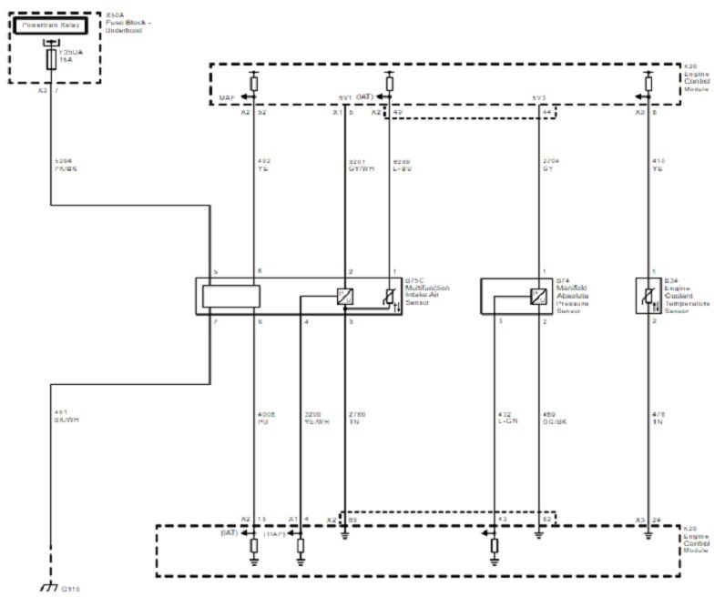

I had my coolant temperature sensor replaced three times in 3 months and it keeps failing. What can I do to keep it fixed??

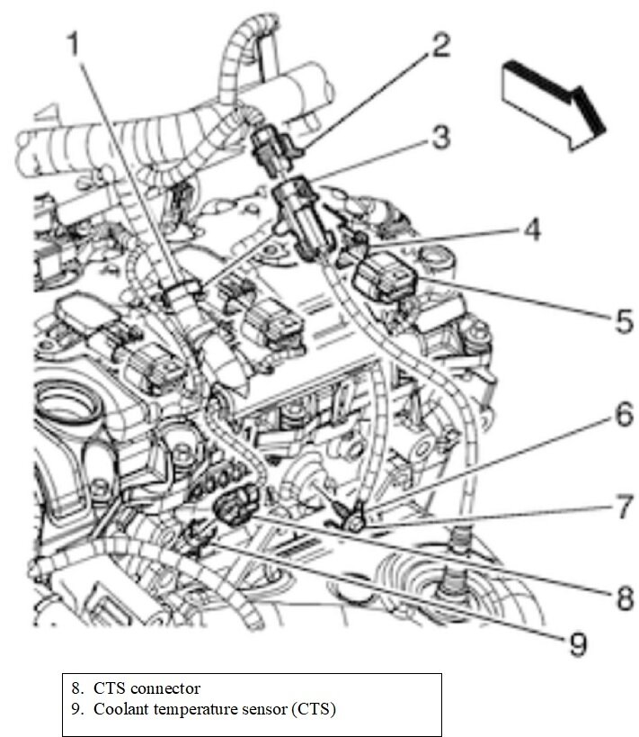

This drawing shows the location of the coolant temperature sensor. There's a heat shield that must be removed to get to it. To be valid, all voltage readings must be taken with the connector plugged in. That's done by back-probing through the rubber weather seals around the wires.

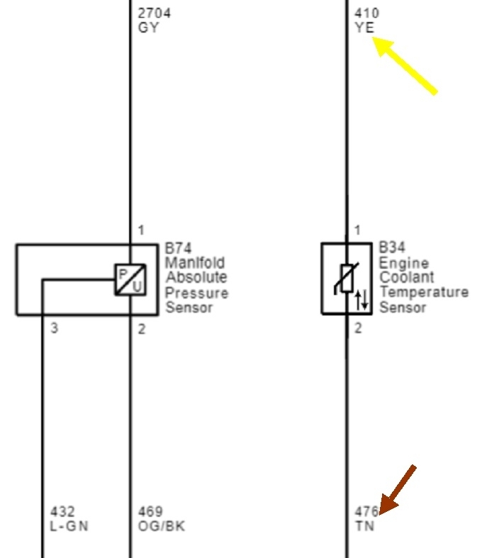

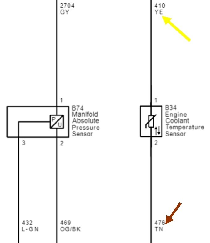

As you can see in the second diagram, these can be rather hard to read. I expanded the coolant temperature sensor in the third diagram to show the sensor has a yellow and a tan wire going to it. The tan wire should have very close to 0.0 volts. The yellow one should have between 0.5 and 4.5 volts, but only when it is plugged in. That's the acceptable range, give or take a little. If it is unplugged, (or has an intermittent connection), it will have the full 5.0 volts. That is one of the values outside the acceptable range that sets a fault code. The other extreme is when the yellow wire is grounded to the engine, then it will have 0.0 volts, which is also outside the acceptable range, and will set a different fault code.
Please understand this appears to be an intermittent problem. Any voltage readings only apply at the time they're taken. Often something has to occur to make an intermittent problem act up, such driving on rough roads, or the rocking of the engine as you accelerate or coast. That's when the Engine Computer will catch the defect and set the fault code, while you won't see it with the voltmeter. This is where it can become necessary to use a scanner to see what the computer is seeing and reacting to.
