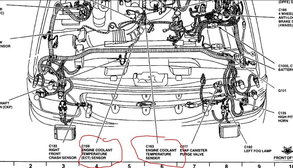

I need location for temp sending unit and sensor.
Nov 10, 2020 at 2:50 AM
Good afternoon,
I attached the location of both sensors. They are located on top of the motor behind the throttle body.

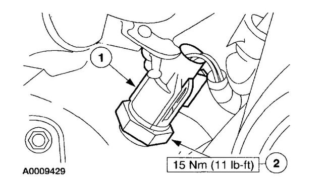

https://www.2carpros.com/articles/coolant-temperature-sensor-cts-replacement
REMOVAL
1. Remove the thermostat and housing. For additional information, refer to Cooling System.
2. Disconnect the battery ground cable. For additional information, refer to Battery.
3. Remove the Engine Coolant Temperature (ECT) sensor.
1 Disconnect the connector.
2 Remove the sensor.
INSTALLATION
1. To install, reverse the removal procedure.
