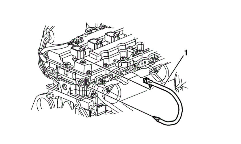

Good afternoon,
Sounds like the coolant temperature sensor has failed.
I attached the location for you of the sensor.
Engine Coolant Temperature Sensor Replacement
Removal Procedure
Notice: Use care when handling the coolant sensor. Damage to the coolant sensor will affect the operation of the fuel control system.
1. Turn the engine OFF.
Caution: Refer to Battery Disconnect Caution.
2. Disconnect the negative battery terminal.
3. Drain coolant below the level of the engine coolant temperature (ECT) sensor. Refer to Cooling System Draining and Filling (LL8) Cooling System Draining and Filling (LH6, LS2).
4. Disconnect the ECT sensor electrical connector (1).

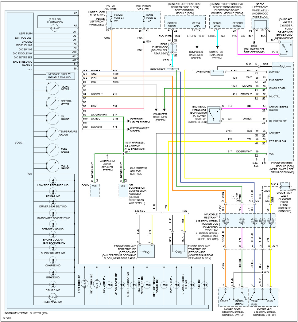

My question is to Ken the Administrator. In a previous blog about 2008 Trailblazer with a temperature gauge intermittently not working and setting code 128, you stated that it traces back to the BCM. Could you kindly explain how the BCM controls this? Could you also tell me the BCM's location and does a new one need to be reprogrammed by the dealer? My 2008 Trailblazer just developed this problem.

I have never seen a P0128 to be caused by a temperature gauge problem. That codes means that the engine is not reaching sufficient temperate to satisfy what the computer has been programmed to look for.

Yes that is what P0128 means but that does not mean that is the problem. My problem is not a temperature problem. My gauge intermittently goes out like when the ignition is off thus setting the code. in another blog feed here by Ken "Admin" mentioned it traces back to the BCM which obviously controls the gauge and possibly the signal from either the temperature sensor or gauge or both to the PCM. When the signal is interrupted to the PCM it sets the code.
Dec 9, 2020 at 4:11 AM (Merged)
WRENCHTECH
  • 20,760 POSTS
The Body Control Module plays no part in the temperature gauge circuit on this vehicle.
WRENCHTECH
  • 20,760 POSTS
What you need to do is monitor the ECT reading with a scan tool and compare it to the dash reading at the moment this is happening.

Thanks. You are suggesting it is the ECT? Others have replaced the ECT and thermostat and still have the problem. Could a bad stepper motor set the code?
WRENCHTECH
  • 20,760 POSTS
I suggested to compare the dash reading with the data reading in the PCM to see if they match when the problem occurs to help isolate the cause.

If in fact you have a gauge issue within the cluster, I do not believe it will set a P0128 code. The PCM sets that using data from the CTS.

Thanks Wrenchtech. So far it seems to be leading toward the stepper motor. I will double check the CTS. The problem is intermittent and I might just change it anyway. If the problem persists then I will rebuild the gauge vluster.
WRENCHTECH
  • 20,760 POSTS
I am not saying the CTS is the problem. It could just as easily be a wiring problem in the circuit or the motor just not getting hot enough. That is what comparing the scan tool data could tell you.This could be as simple as the plug at the CTS being bad.
