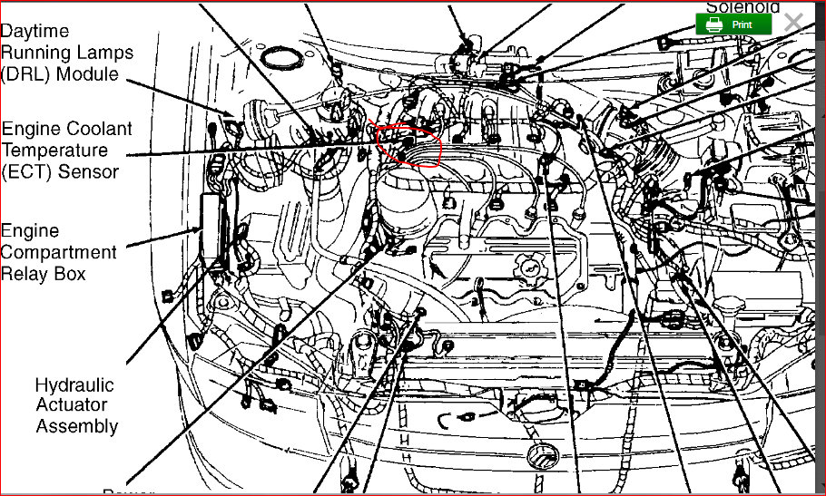

Have heat just no gauge. Too risky to keep on driving waiting for failure. How does one fix gauge or should I add my own temperature gauge?

It sounds just like your ECT (Engine Coolant Temperature Sensor) is not working. No need for an additional gauge.Let's fix yours. Here is a tutorial showing what's involved:
https://www.2carpros.com/articles/coolant-temperature-sensor-cts-replacement
https://www.2carpros.com/articles/symptoms-of-a-bad-coolant-temperature-sensor
I've attached a picture below showing its under hood location and circled it in red.Hope this helps and thanks for using 2CarPros.

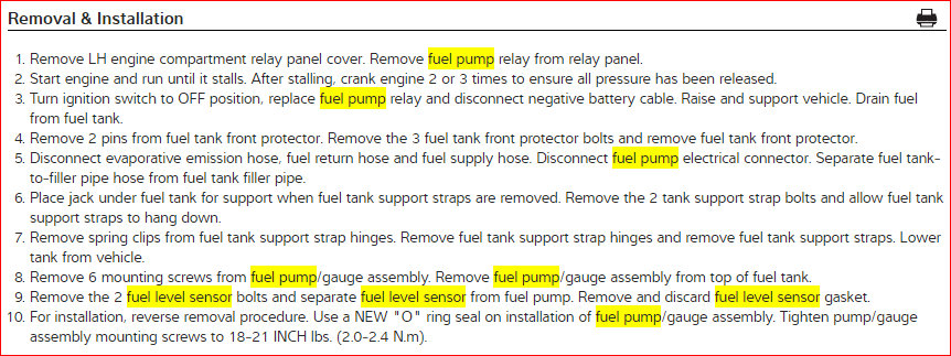

Both gauges are not working. Fixing to replace temperature sensor. Any advice on gas gauge?

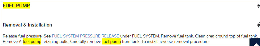

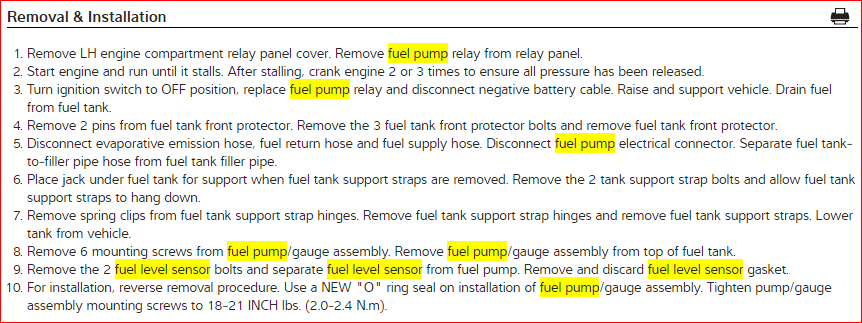

It sounds like the fuel gauge sending unit is giving you a problem.The sending unit and the fuel pump are a complete assembly are are mounted inside the fuel tank.You will have to drop the fuel tank to gain access.Here is a tutorial showing the procedure:
https://www.2carpros.com/articles/how-to-replace-an-electric-fuel-pump
I've also attached below a picture of step-by-step instructions for your vehicle.Hope this helps and feel free to ask any more questions if needed.Thanks again for using 2CarPros.
