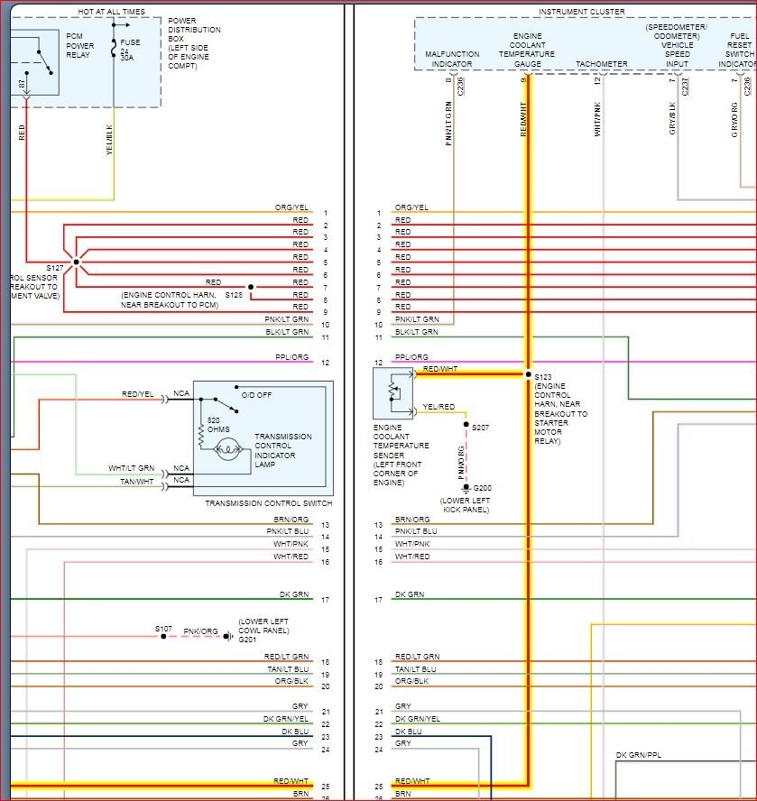

Hi Jeff,
If you check out the wiring diagram of this circuit you will see the temp sensor is a direct feed to the gauge in the cluster. It also splices off and sends the into to the PCM. Due to the issue being the gauge is not working, you can assume the issue is most likely the sensor, wiring, or gauge itself.

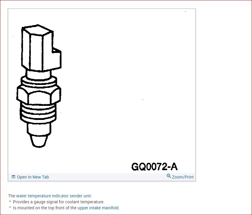

What I would do first, is test resistance on your temp sensor. Just hook the red lead for you meter to the Red/White wire for the sensor and the Black lead to the other wire in your sensor. If the engine is cold, I would expect to see about 2 ohms of resistance. The hotter it is, the lower the resistance.
Since your gauge is not working, if the sensor is the issue, I suspect you will find high resistance or an open. If this is the case, go no further until you replace that sensor.

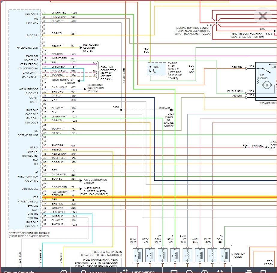

Can you send me the voltage reference from PCM to ECT at plug with key on power and the resistance at sensor please?

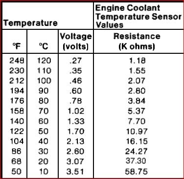

So I think this will be what you need. This is from Ford but it doesn't give me specific engines it applies to but usually these parameters are standard across all lines and OEMs.
So depending on when you took that resistance reading (assuming cold engine) it is reading the temp was about 150 degrees so it appears it is not accurate.
It also gives you the voltage readings. This is what the PCM is going to be looking at. As voltage drops, the temp rises, same with resistance.
Jun 2, 2019 at 6:16 AM

The voltage at ECT plug from PCM is 11.34 volts on red and white wire not even in ball park it should be 5 volts so the thing that sends that is the PCM.
Jun 2, 2019 at 6:25 AM
Yeah. That will do it. Thanks for updating with what you found. Very good diagnosis. Thanks
