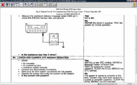

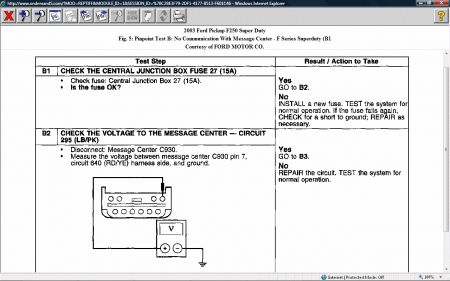

my trip computer all of a sudden went blank
Sunday, November 2nd, 2008 AT 5:57 PM
MERLIN2021
  • 17,250 POSTS
Here's the troubleshooting flowchart. First try turning the key on and hold the mode button, if it lights up, it was inadvertantly shut off, if it does not light up, try these steps, or have it scanned for codes by a shop that can read "B" codes.
https://www.2carpros.com/forum/automotive_pictures/62217_1Cleanup_1.jpg
https://www.2carpros.com/forum/automotive_pictures/62217_2_4.jpg
