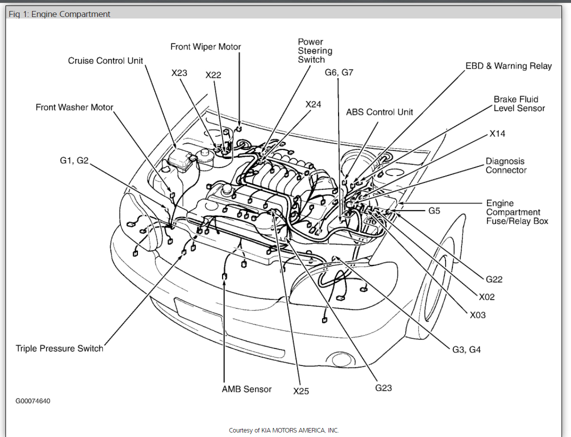

Temperature gauge show hot but engine not over heating.
Aug 6, 2017 at 8:16 AM
Experienced Mechanic
55,561 POSTS

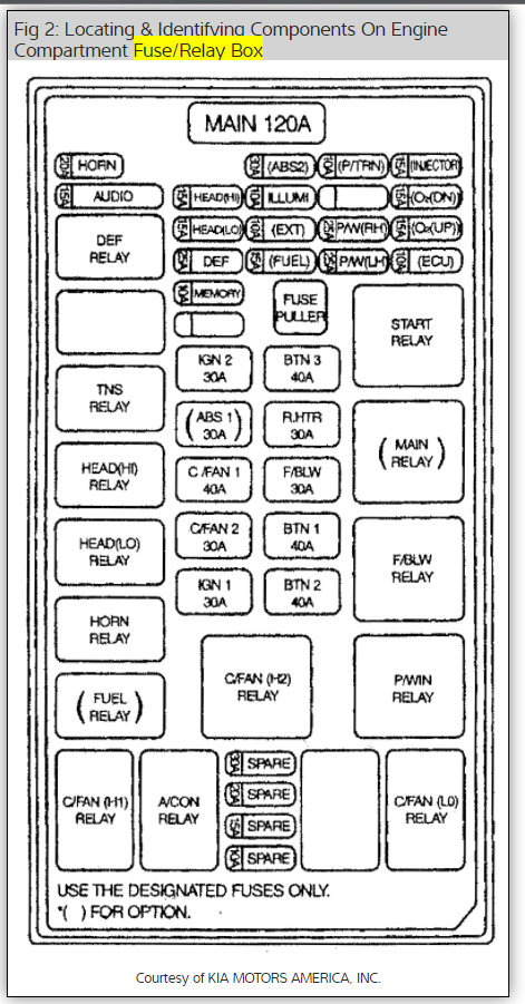

When you turn the A/C on do you hear the cooling fans running? If not here is a guide to help you confirm the problem:
https://www.2carpros.com/articles/how-an-electric-cooling-fan-works
and
https://www.2carpros.com/articles/engine-overheating-or-running-hot
and
https://www.2carpros.com/articles/symptoms-of-an-overheating-engine
and
https://www.2carpros.com/articles/replace-electric-fan-motor

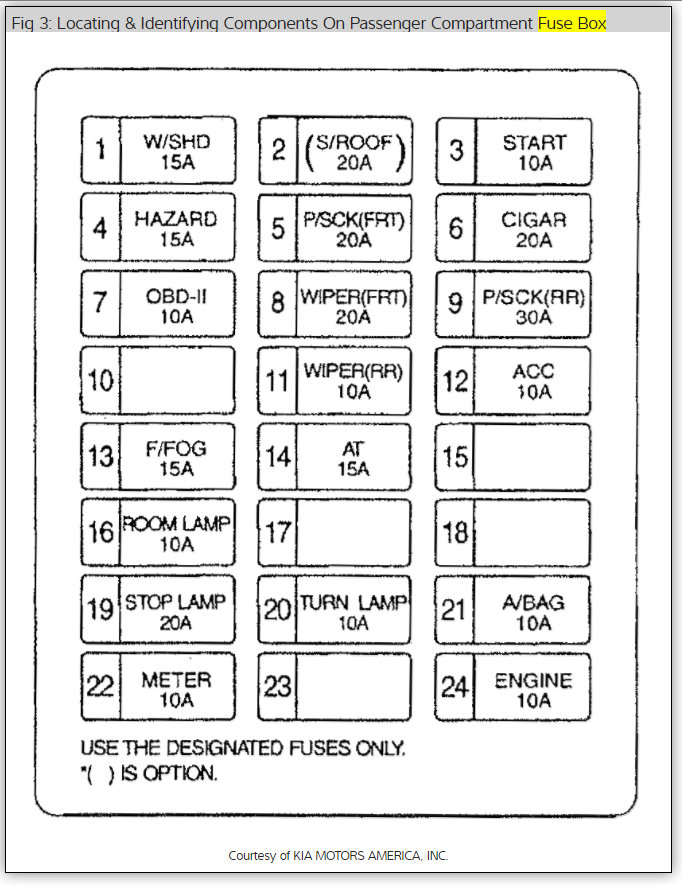

Also, check the fuses.
Here are some diagrams below:
