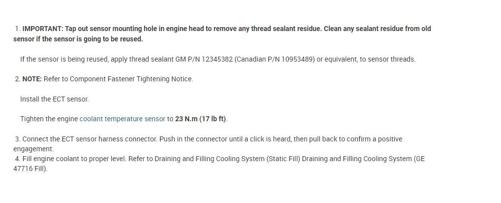

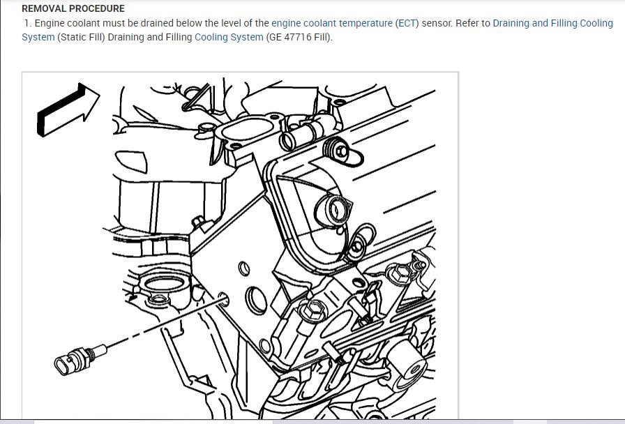

Good afternoon,
The coolant temperature switch is the controlling sensor for sending a signal to the cluster for the engine temperature. I would suspect that it is filing and I would replace it.
https://www.2carpros.com/articles/how-a-coolant-temperature-sensor-works
I attached the procedure below for you.
https://www.2carpros.com/articles/coolant-temperature-sensor-cts-replacement
