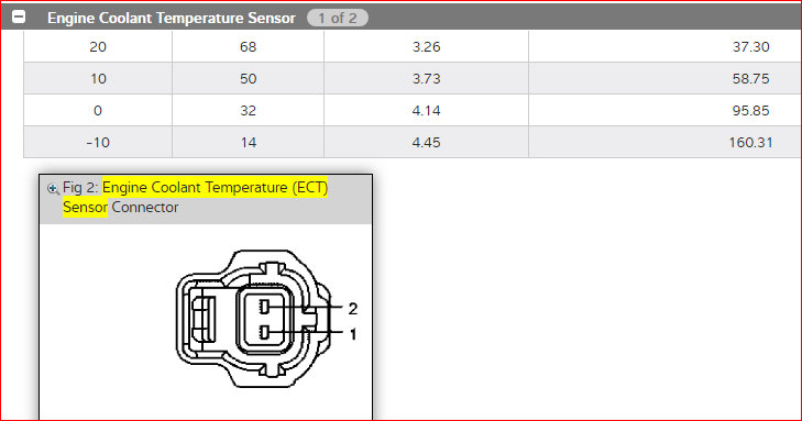

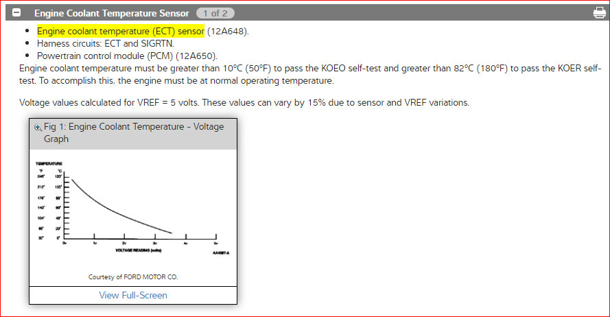

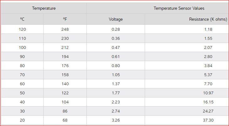

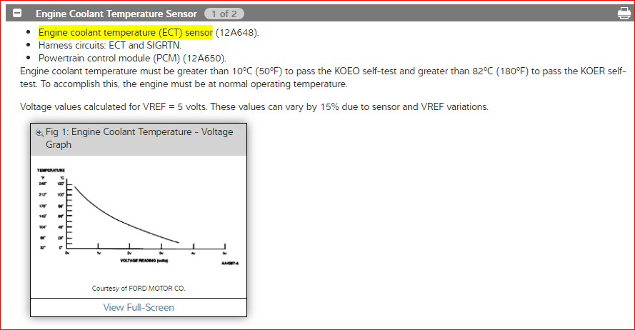

So the coil pack was cracked. New pack, wires and plugs no more rough issues. The temperature gauge still does not work even with a new thermostat. No codes. How do I test the sensor for the gauge?
Sep 19, 2018 at 9:32 AM
DANNY L
  • 5,648 POSTS
Hello again.
I have attached a diagram for you. You can use a volt meter to test the coolant temperature sensor. It is located on the right side of the lower intake manifold. Hope this helps and thanks again for using 2CarPros.
Danny-
Sep 19, 2018 at 11:44 AM
SMB985
  • 6 POSTS
Thanks but unfortunately I am not able to locate the sensor. Would you happen to have a picture or diagram where it would be?
Sep 20, 2018 at 9:16 AM
SMB985
  • 6 POSTS
Our local Library does not have a repair manual for this vehicle.
Sep 21, 2018 at 12:26 AM
  • 55,421 POSTS
Hello, At ECT sensor harness connector. - Component Location: Right side of the lower intake manifold: Here is a guide that will help you step by step to replace it:
