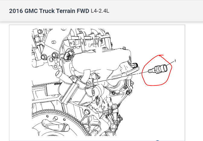

The first thing I would check is the coolant temperature sensor to make sure the wiring and connector are in good condition. If they are, I would likely change the sensor.
Since it does work at times, chances are it is a connector issue, so disconnect it and inspect the connector pins for damage or corrosion.

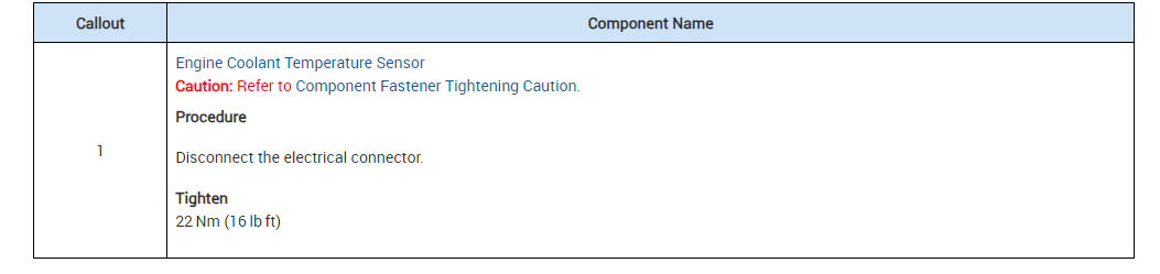

I attached the directions below for replacing it. Note: The directions are extremely vague. You can either drain the engine coolant below the level of the sensor or be fast in replacing it. Coolant will leak from the engine when it is removed.
Also, here is a link explaining how it's done. It is on a different vehicle, but the same principles apply. It may be more helpful.
https://www.2carpros.com/articles/coolant-temperature-sensor-cts-replacement
Let me know what you find or if you have other questions,
