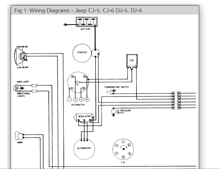

It has one wire going to it. There is no voltage on the wire. The engine is not overheating but I would like to get the gauge working again. It is a gauge, not just a warning light.
My question is, should the gauge have 12 volts going to it all the time?
Sep 23, 2019 at 9:42 AM
SCGRANTURISMO
  • 4,897 POSTS

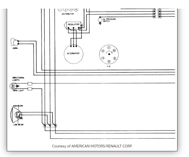

There is only one wire going to the gauge as the wiring diagram with the temperature gauge circuit in it shows that I have included for you in the diagrams down below. If the gauge isn't working and there is no voltage in the wire, then this shows that the temperature sending unit/switch is bad and needs to be replaced. Please get back to us with how everything turns out.
