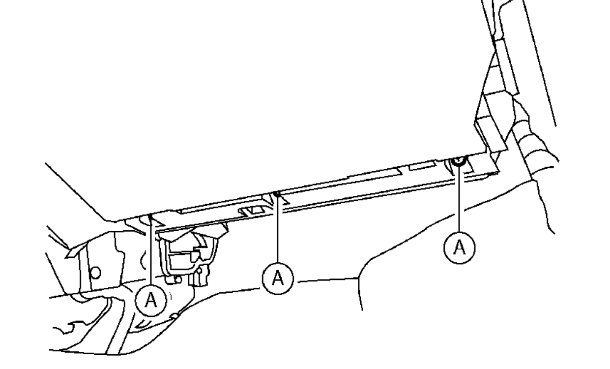

The car cools nicely but will not change to heated air, where is the temperature blend door located?
2013 NISSAN SENTRA
68,000 MILES • 4 CYL • 2WD • AUTOMATIC
SMOKEYMO
I am thinking the temperature blend door but, not sure where it is located to see if it is changing.

Hello, typically the blend door or "air mix door" actuator can be seen behind the glovebox. But it depends on if you have manual A/C or automatic A/C controls. Can you let me know which one you have? If you just have simple knobs for temperature and air mode, then it is manual.

It is manuals A/C.

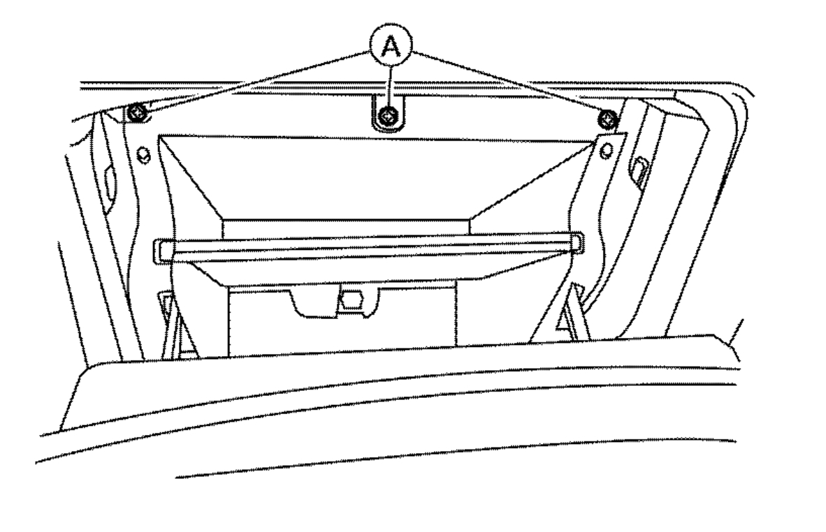

Okay, this should be straight forward then. First you need to remove the glovebox compartment. This can be done by removing the three screws on the top (See image 01) and the three screws on the bottom (See image 02). The motor should be clearly seen after this.
AIR MIX DOOR MOTOR: Removal and Installation
REMOVAL
1.Remove the glove box assembly. Refer to "Removal and Installation" See: Glove Compartment > Removal and Replacement > Removal and Installation.
2.Disconnect the harness connector from the air mix door motor.
3.Remove the air mix door motor screws and the air mix door motor.
