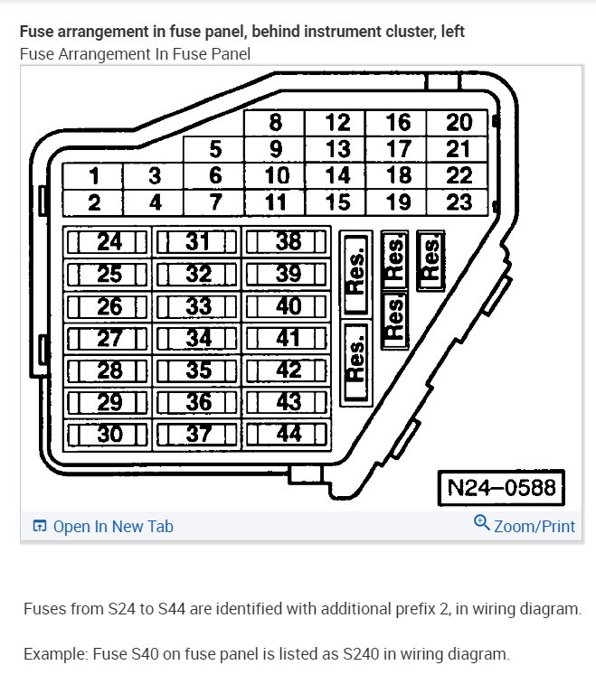

car cranks and starts for a few seconds and then shuts off. The diesel pump was replaced by the dealer 4 years ago and was working fine. was automatic and turned into std. traveled 2,000 miles trouble free and all of a sudden started acting up. I had to push start it once in reverse and started smelling like burned, as in electronic wires. Any advice?
Oct 29, 2023 at 12:46 PM
  • 55,694 POSTS

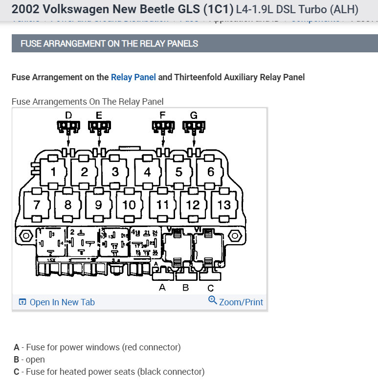

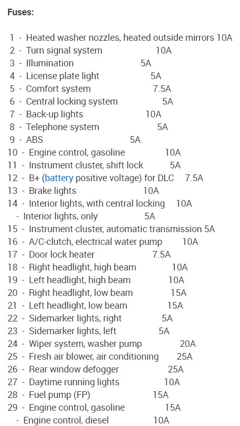

I would check the wiring harness for the engine to make sure nothing got pinched when installing the manual transmission. This is typical when an R&R occurs. Next check the fuses this guide can help, please check the fuses with the ignition system on:
If all fuses are okay let's run the codes to see if any are stored.
