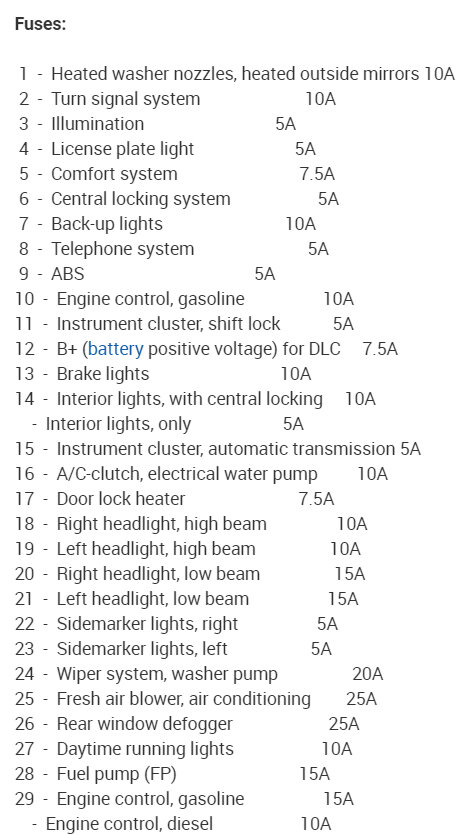

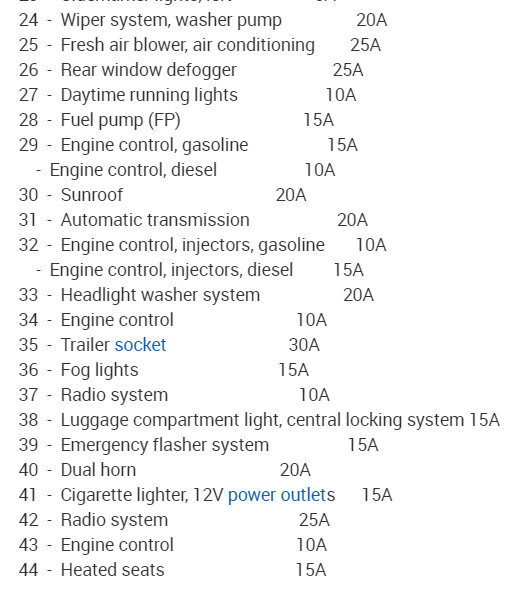

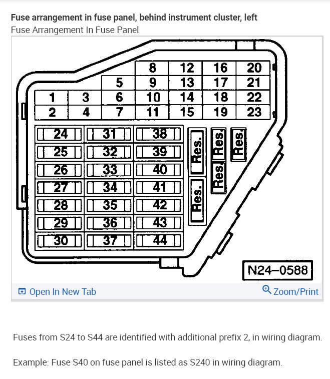

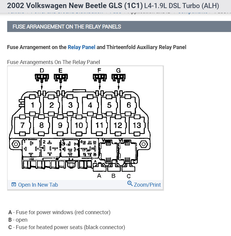

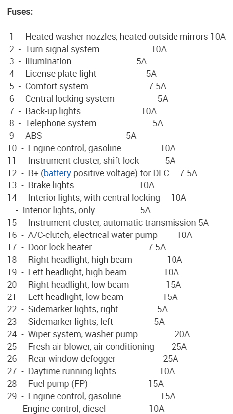

I would check the wiring harness for the engine to make sure nothing got pinched when installing the manual transmission. This is typical when an R&R occurs. Next check the fuses this guide can help, please check the fuses with the ignition system on:
If all fuses are okay let's run the codes to see if any are stored.
