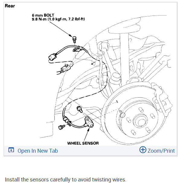

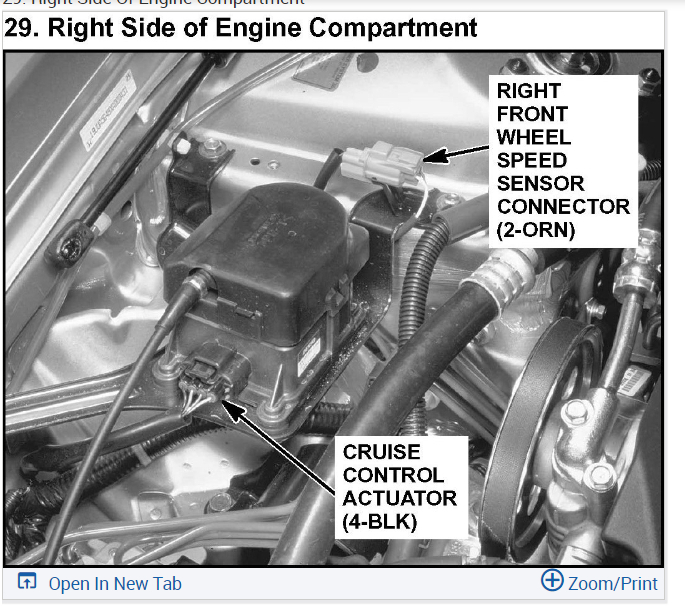

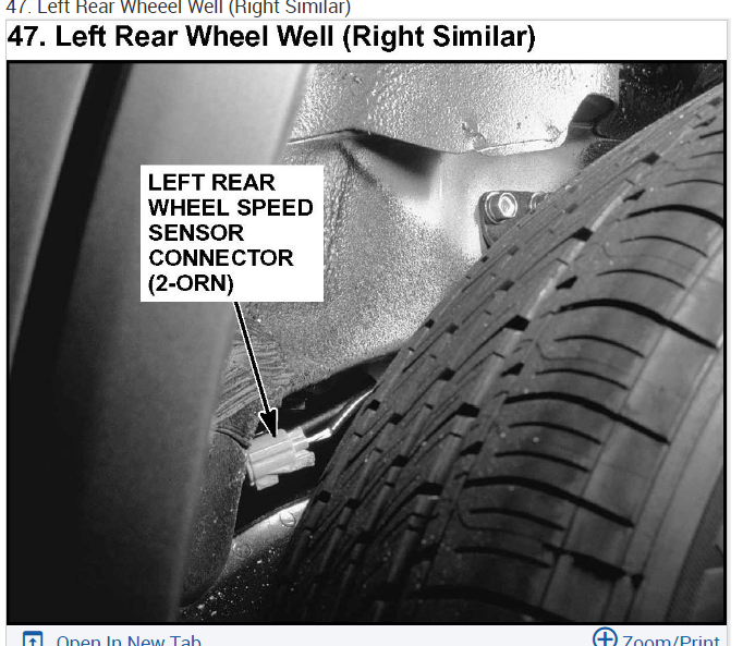

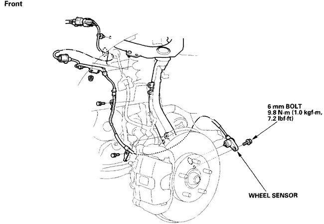

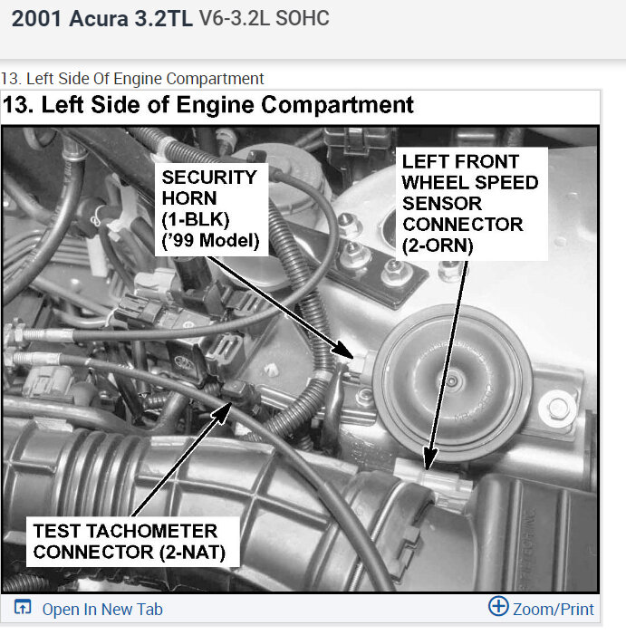

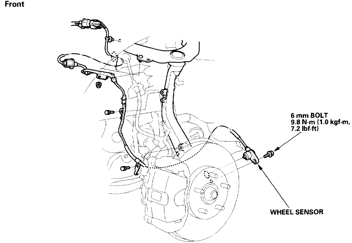

We need to run the codes, this guide can help.
It sounds like when the car was getting inspected one of the wheel speed sensor wirings got damaged. I would raise the car up to inspect here are the location of the wheel speed sensors. Also check out this video for the idling problem,
https://youtu.be/XMB16Gg-qNg?si=vdhChI_SWIDXz6cW
