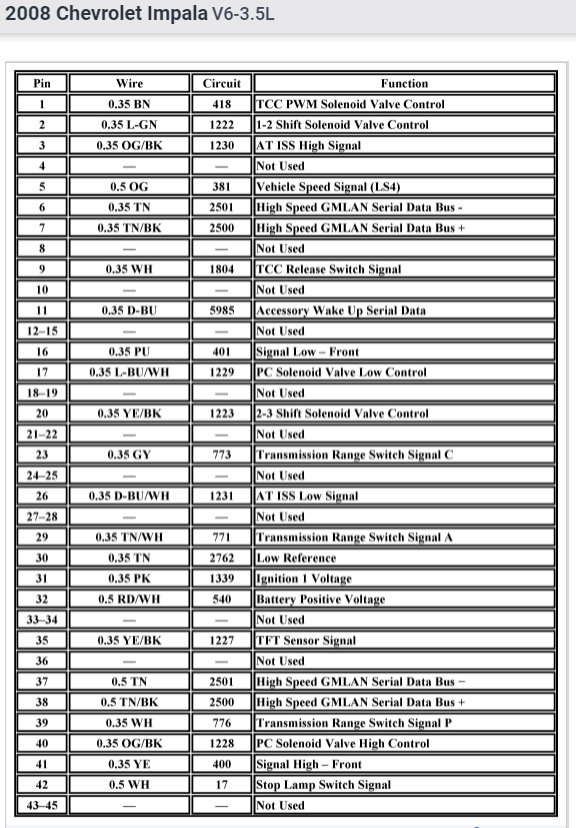

Code p0850.
Dec 15, 2021 at 5:14 PM
SQM
  • 6,383 POSTS
In the US they did not make the Lumina in 2008.

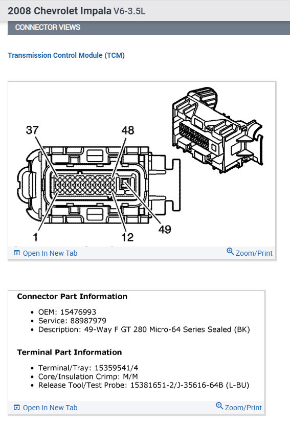

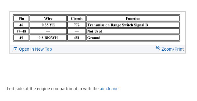

I have attached the pinout diagram for the 2008 Impala with the 3.5L engine.
It may or may not be the same.
Are you getting any code besides the P0850? As this one does not have information for our catalog.
What kind of issues are you having with the vehicle?
