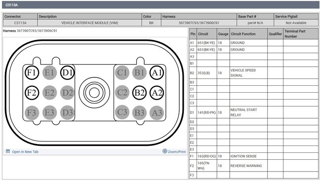

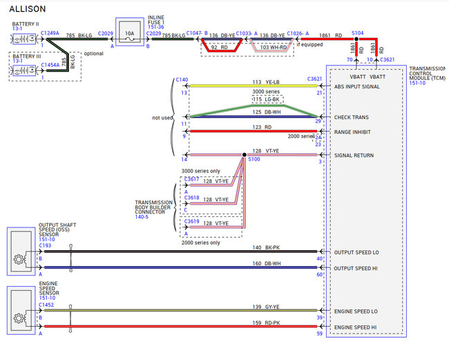

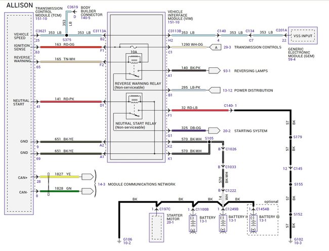

The new transmission control module is not letting the truck start because it thinks it is in gear, I need a TCM Wiring Diagram.

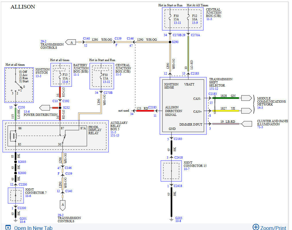

Usually this will be a transmission shift selector that is going out FYI. Here are the wiring diagrams for the TCM as requested, pleas let me know what you find, Check out the images (below). Ken

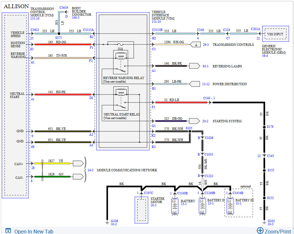

I need a wiring diagram for the vehicle interface module for the truck listed.

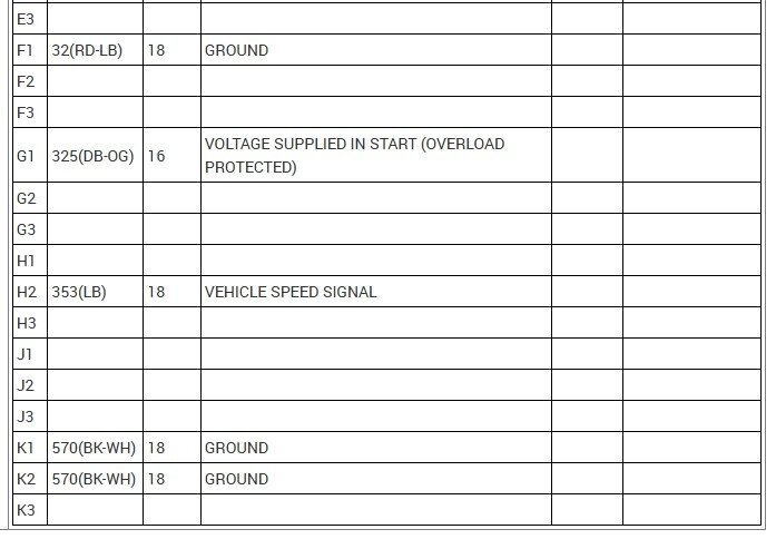

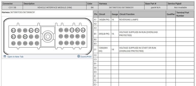

The VIM on that truck is really just a relay box. Most of the wiring just passes through. Attached are the wiring and the connector views for it. The relays are soldered to the board but you can replace them with external relays for the neutral start and back-up lights if the module has failed.

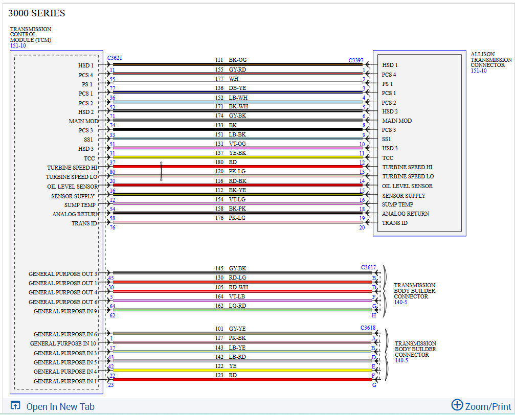

I need a transmission control module pin-out.

Is there something we are missing here? This is all the information we have. Ken

Do you have a pin out diagram for the connector that goes into the side of the transmission?

The is all the information we have. Ken
