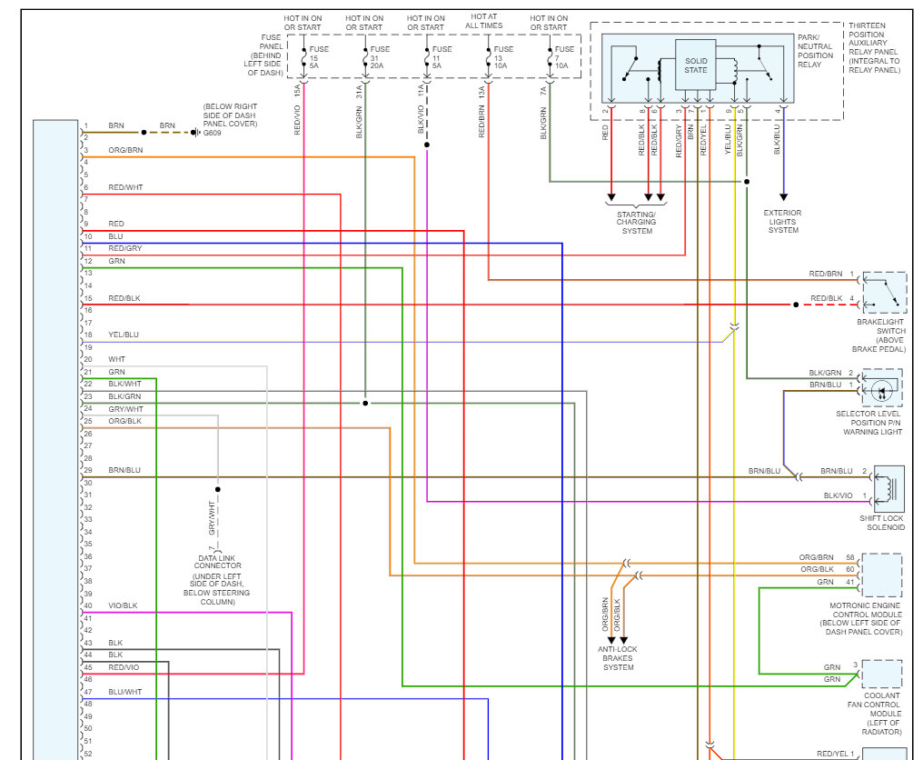

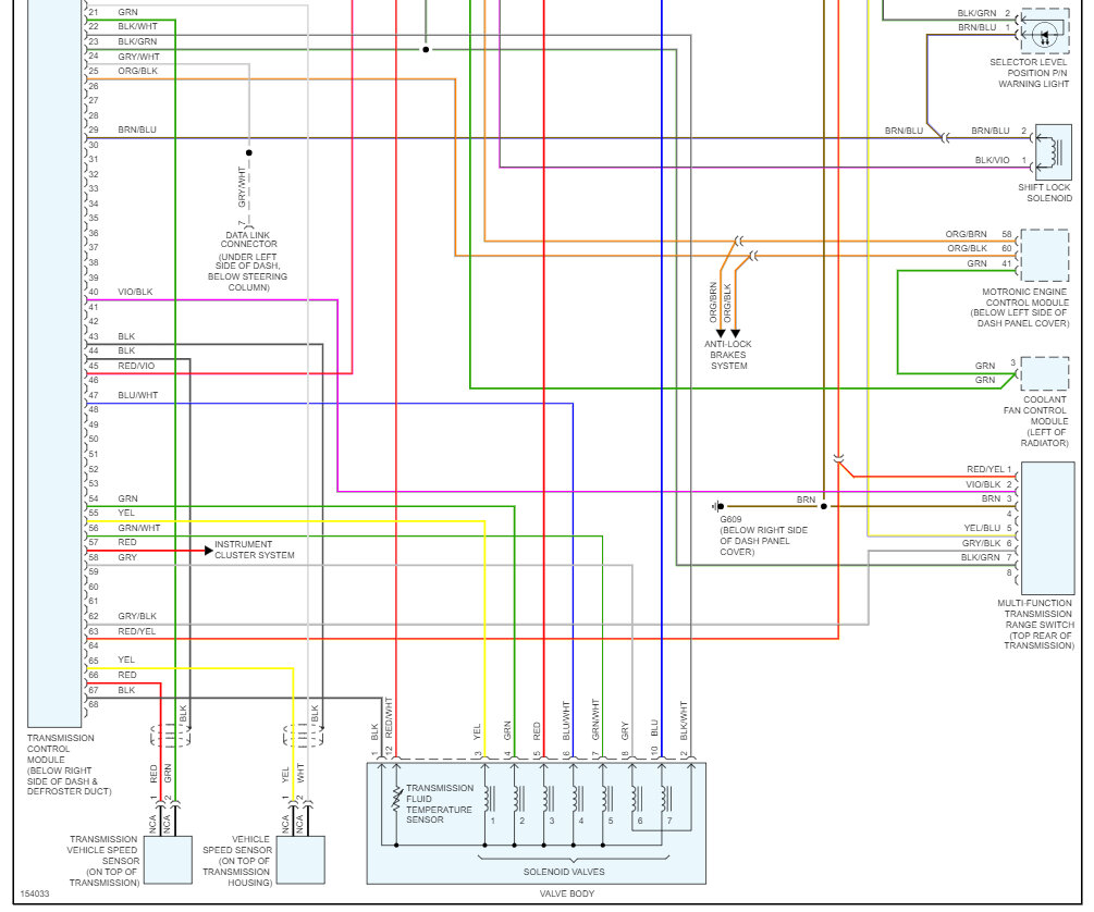

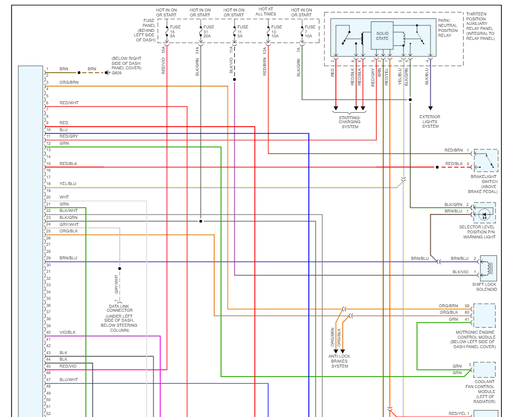

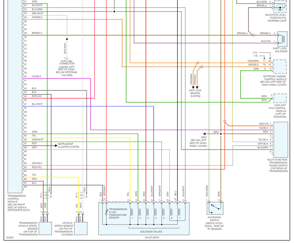

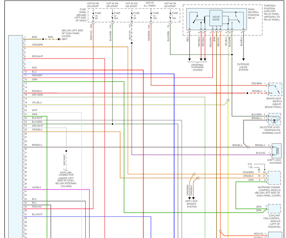

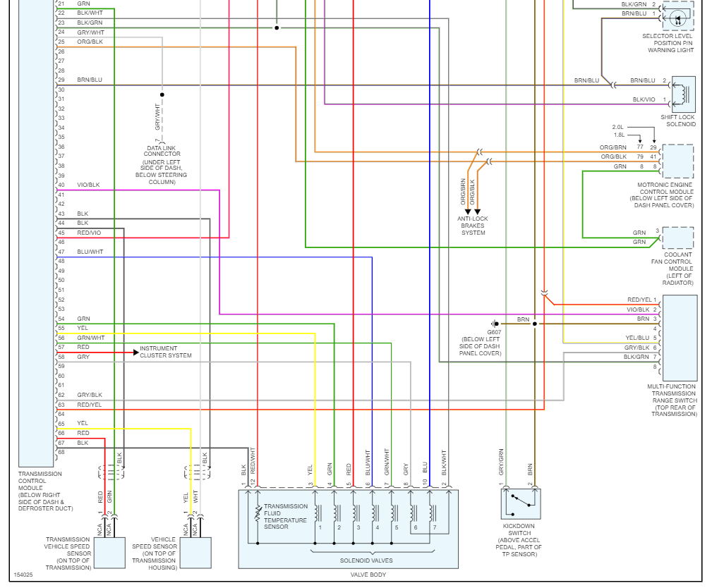

I get code P0722 output speed sensor circuit no signal. Could you please provide TCM wiring diagrams to check the wires for any open circuit? my transmission is 01M 4speed, gas engine 2.0l, the TCM PN is 01M927 733 KQ.
Sep 18, 2023 at 7:44 AM
  • 54,837 POSTS
Did you replace the output speed sensor? Here is a guide to help with the testing and the TCM wiring diagrams as requested:
Transmissions - A/T Circuit (Early Production)
Transmissions - A/T Circuit (Late Production)
Check out the images (below). Please let us know what you find.
