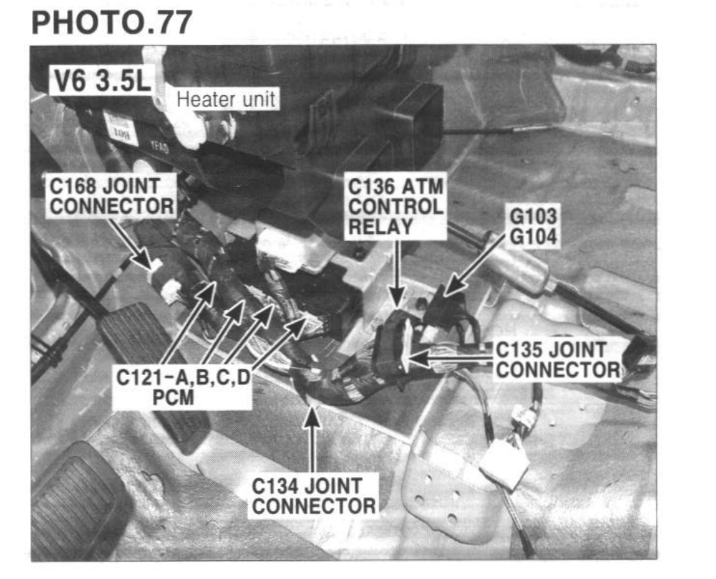

TCM relay location, code P0885
150,000 MILES • 2.0L • 2WD • AUTOMATIC
JAMAL MOHAMAD
where is the TCM relay located? Check lights on... scanned P0885 error.. TCM power relay control circuit open.

It looks like it is under the center console I would check for water damage as well. Here is a guide to help test tit and the location of the TCM in the diagrams below:
