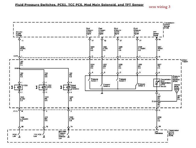

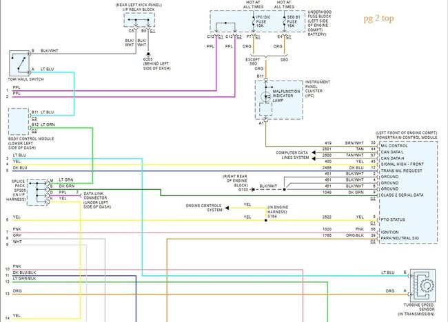

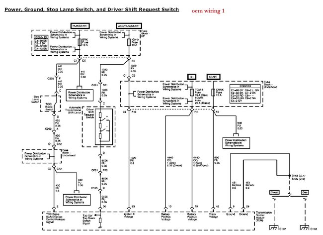

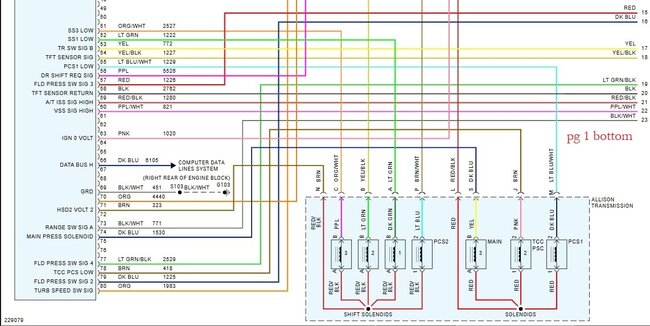

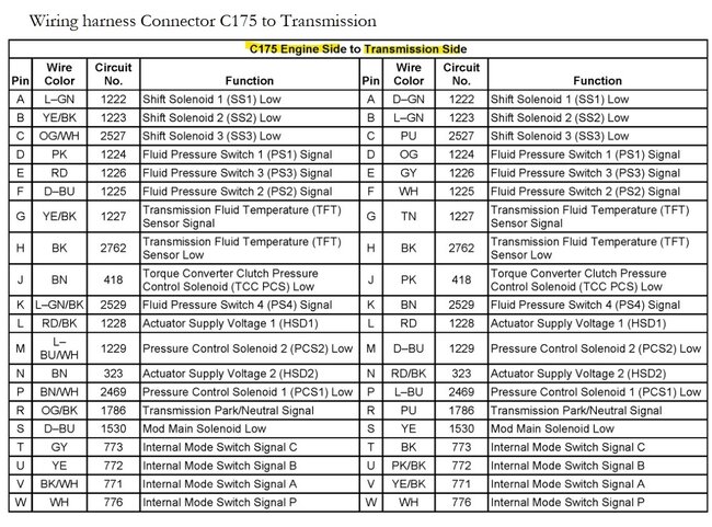

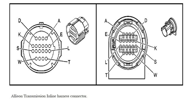

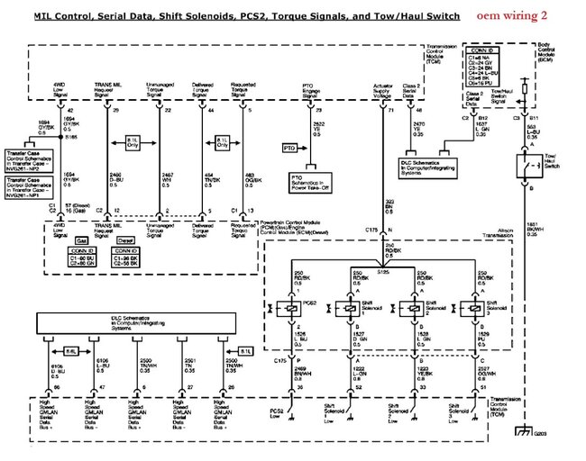

hi I'm looking for a TCM to trans pinout/diagram. the truck is a 2006 Silverado 3500 cab and chassis Duramax with the Allison 6 speed. the harness got torn up and there's a couple of wires in there that are the same colors. thank you

Hello, I do see there are a couple wires the same color on the wiring diagrams, give me a few minutes to get these ready for you.
Feb 18, 2026 at 11:44 AM
AL514
  • 5,692 POSTS

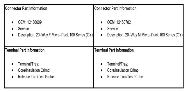

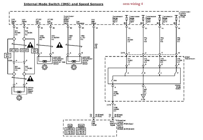

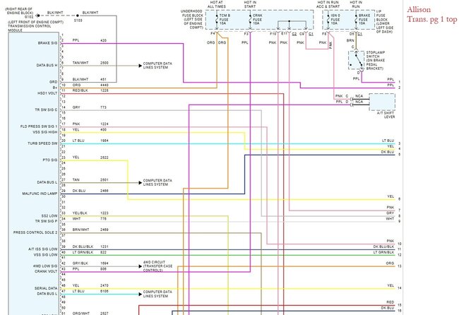

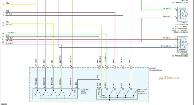

Here are the wiring diagrams for the Allison transmission, the aftermarket and oem wiring. With an inline connector and pinout. Hopefully this is the correct info you were looking for.
