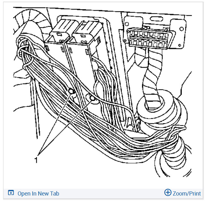

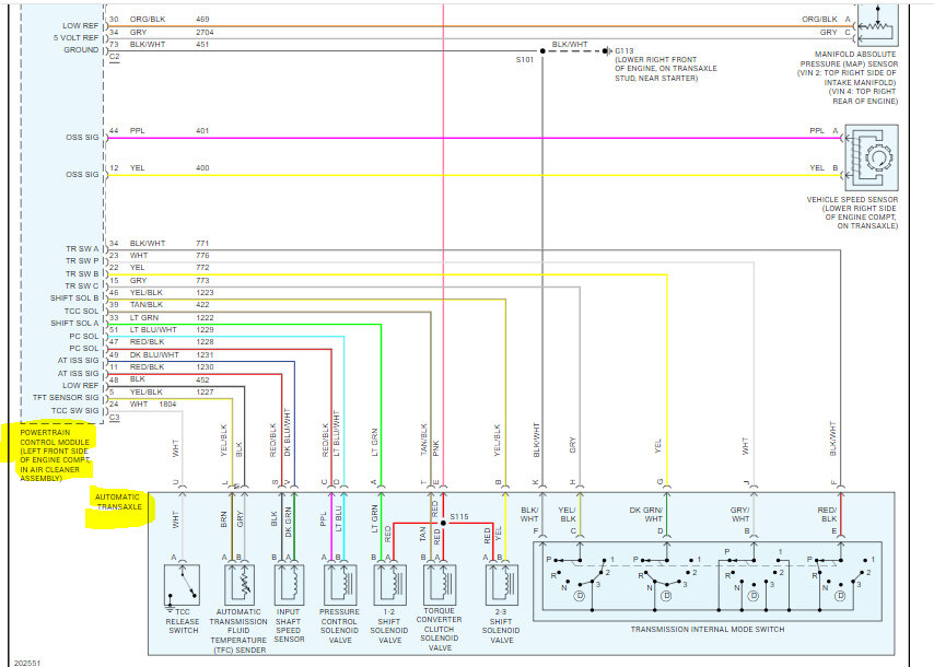

I'm needing to replace the TCM in my car listed above GT, but can't find where it's located?

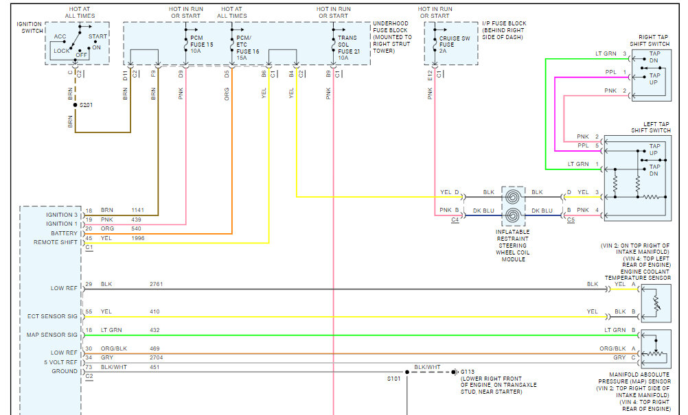

This vehicle doesn't have a separate module for the transmission (TCM). Instead, the transmission is controlled by the powertrain control module (PCM). It is located at the front left (driver's side) of the engine compartment.
I attached the wiring schematic below, so you have a reference.

See pics below. Note: I had to cut the schematic in half to make it readable. I did overlap the two so you can follow from one to the next.

There is only the PCM that controls the transmission. The PCM is under the dash on the left side near the data port connector. Check out the images (below). Let us know if you need anything else.
