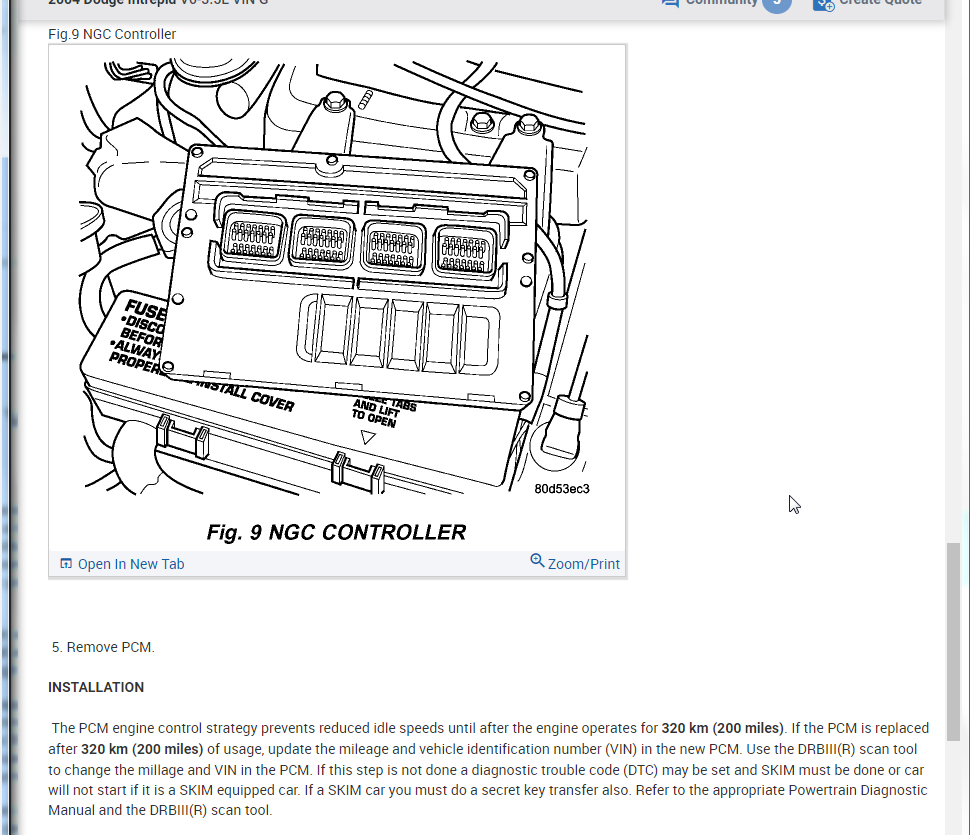

I've about given up. Seeking location to my Transmission Control Module on this vehicle has me nuts. Done research and looked. It's not behind battery nor is it drivers side behind head light. If anyone has an idea, please help me put.
Apr 18, 2021 at 12:27 PM

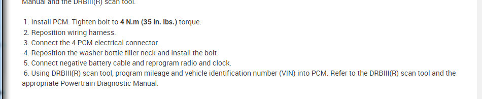

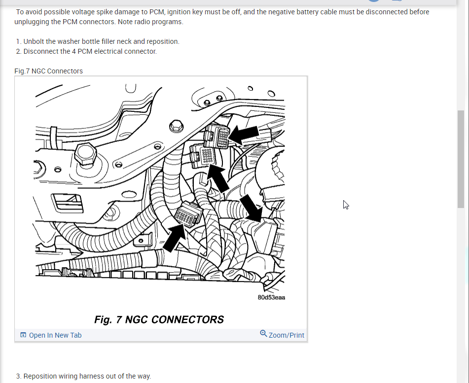

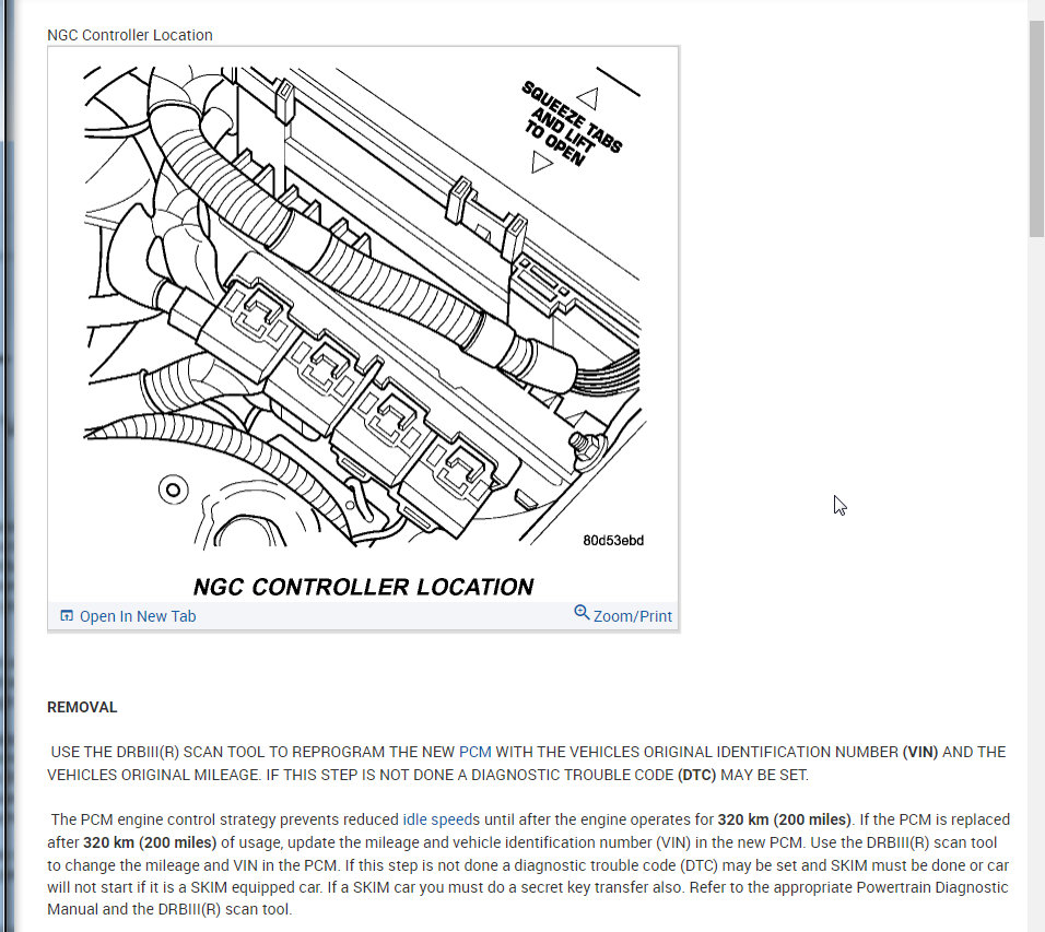

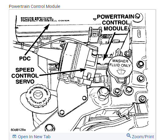

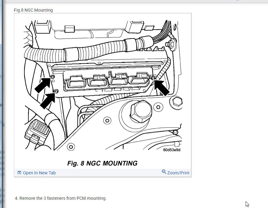

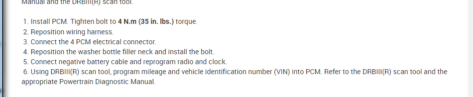

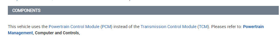

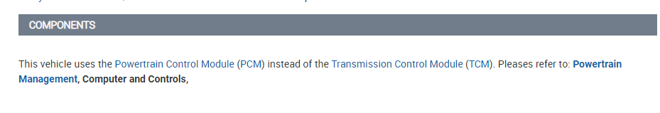

I can understand this frustration. You will not find it because this is a vehicle that uses what is called an NGC controller. So the PCM and TCM are the same component. Basically the PCM does the job for both.
Please see the info below on this and let us know if you have any other questions. Thanks
