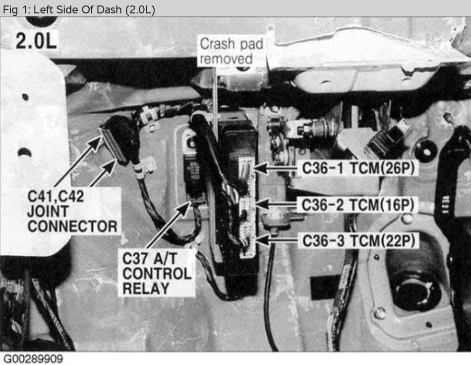

I am looking for the location of the TCM on my car, i have looked behind radio, behind dash board still cannot find it. help please!

we need to know the model.

It is a Hyundai Coupe 2.0 automatic SE 2006.

we do not list just a Coupe. is it a Sonata or something like that?

It is a Hyundai Coupe SE.

we do not list this in USA. I looked it up and it is similar to a Hyundai Tiburon see picture so the location may be the same this is for a 2.0L.
Image (Click to enlarge)
