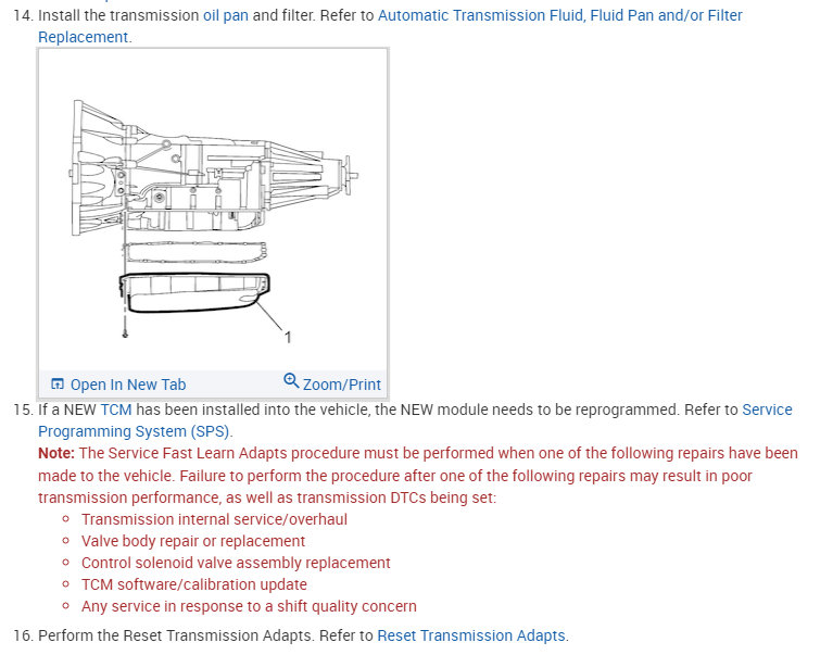

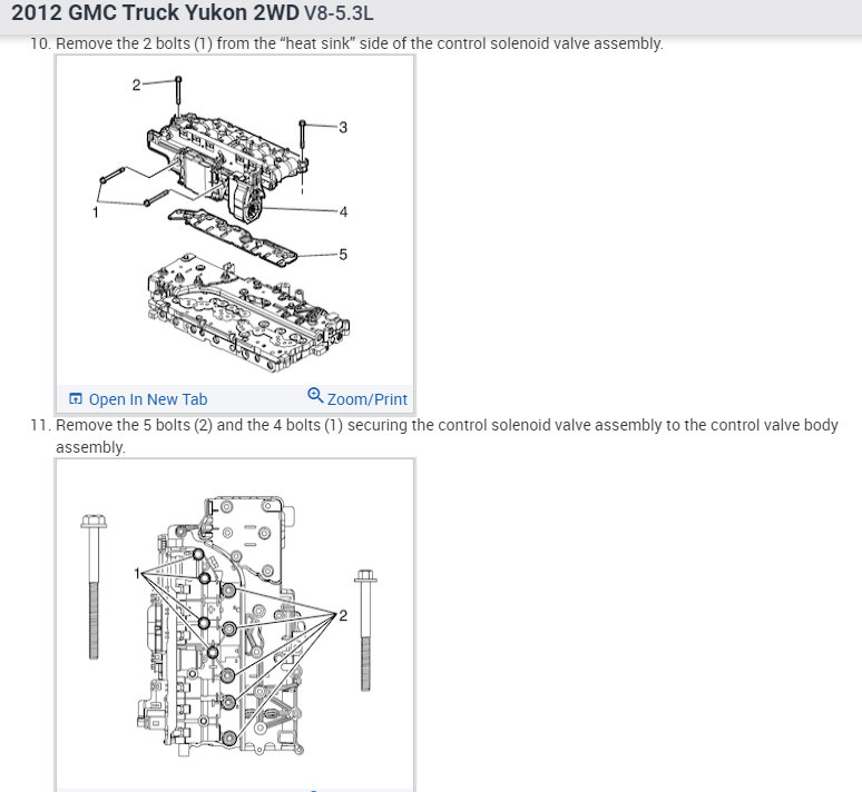

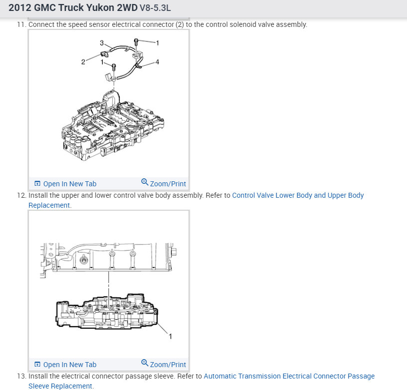

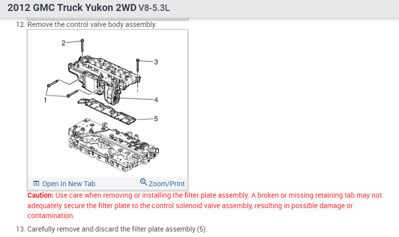

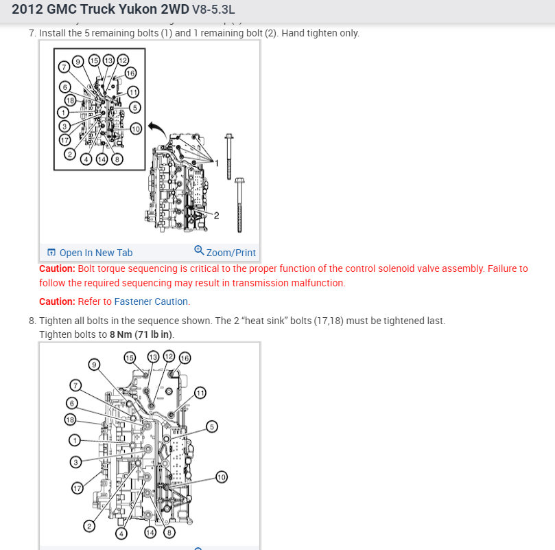

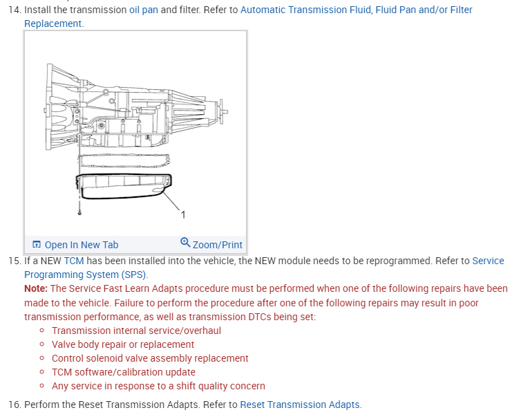

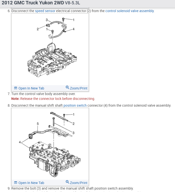

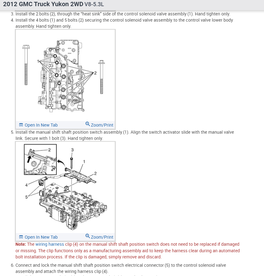

Can someone please tell me where the transmission control module is located on the vehicle listed above SLT model with a 4.7 v8? My husband has looked in multiple places, but we cannot find it. Can someone help me please?
Dec 11, 2021 at 11:29 AM
SQM
  • 6,383 POSTS

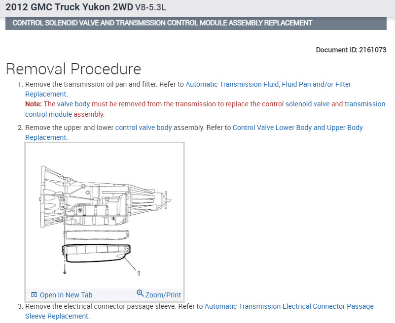

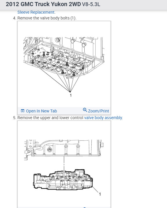

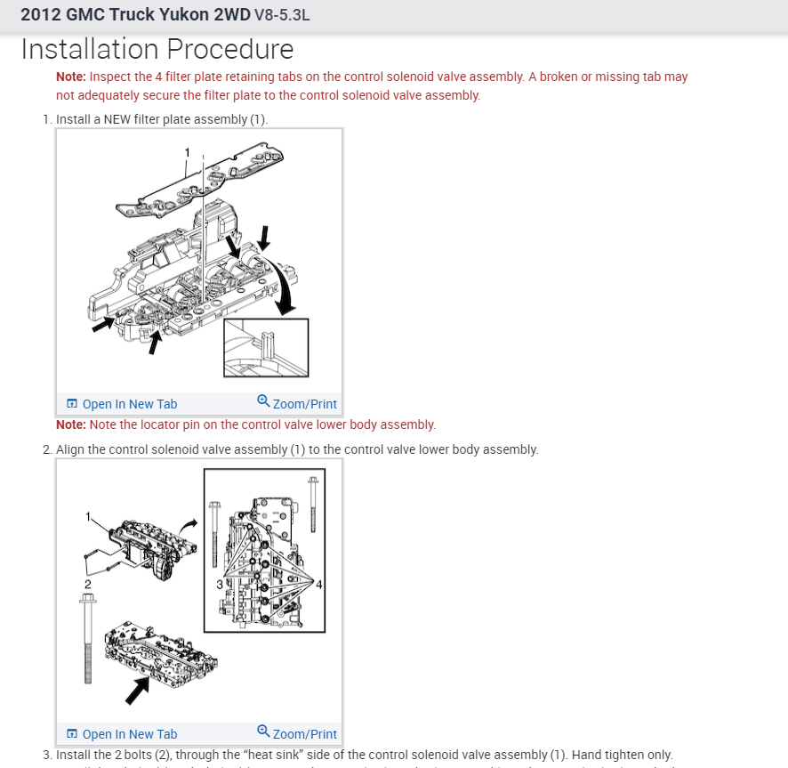

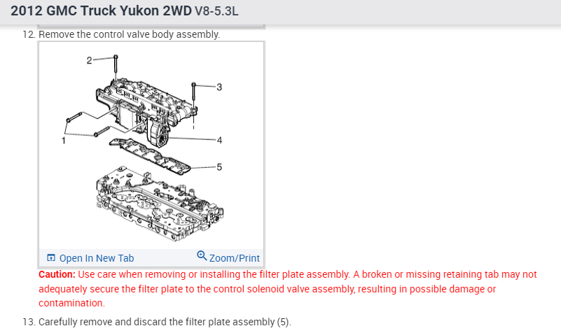

Yes, the TCM is located in the transmission and the transmission pan needs to be removed in order to access the TCM.
