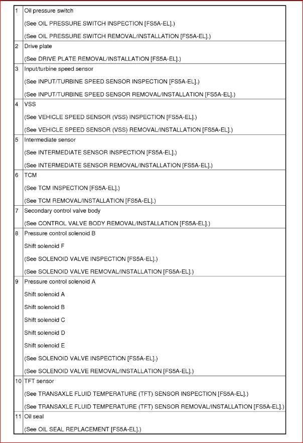

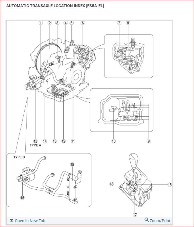

Where can I locate the TCM?
Jun 12, 2019 at 7:46 AM

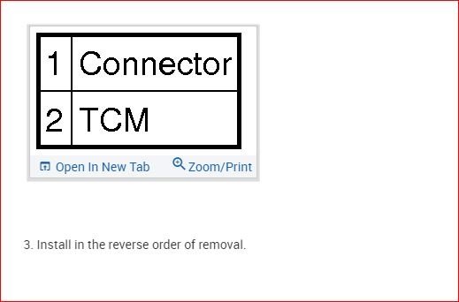

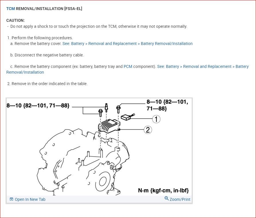

Hi Mayra,
Please see the attached documents. #6 is the TCM.
I also included the removal procedure. Please let me know if you have any other questions. Thanks
