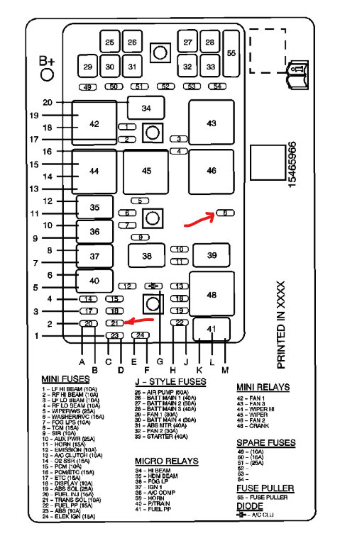

Before replacing the TCM you might want to check the fuse: TCM fuse #8 and Trans sol# 21 in the fuse panel under the hood which powers the TCM.
Code P0700 - Transmission Control System (MIL Request)
Code P0722 - Output Speed Sensor No Signal
This guide can help you test the fuse for power as well, (key on)
Here is the location of the fuse and the TCM is located at the left front of the engine compartment. Check out the images (below). Please let us know what happens.
