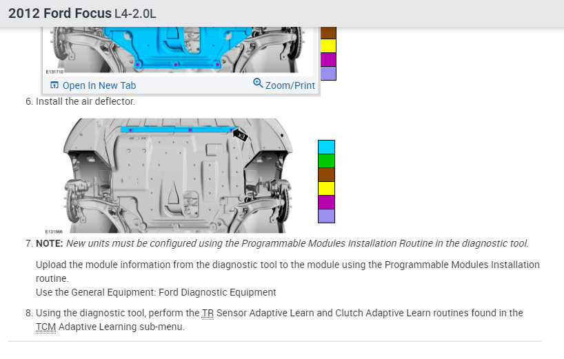

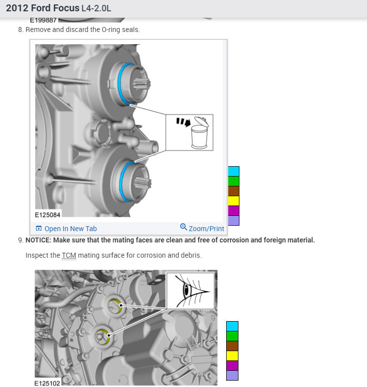

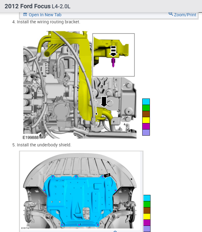

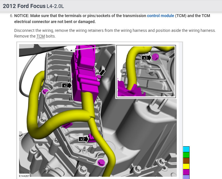

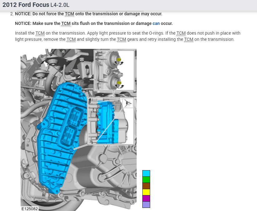

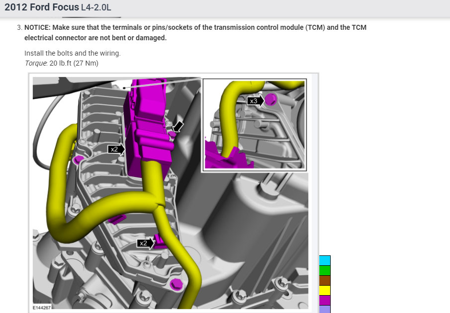

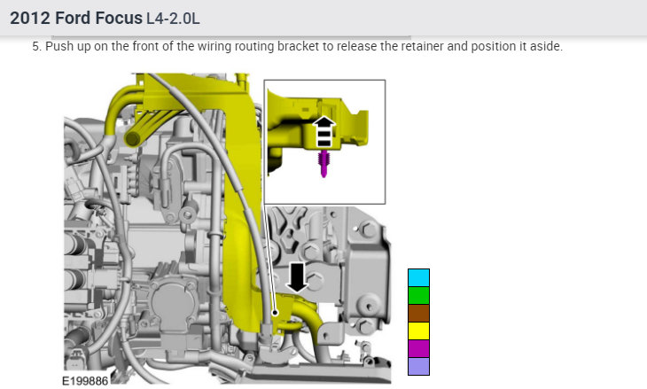

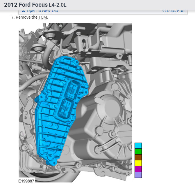

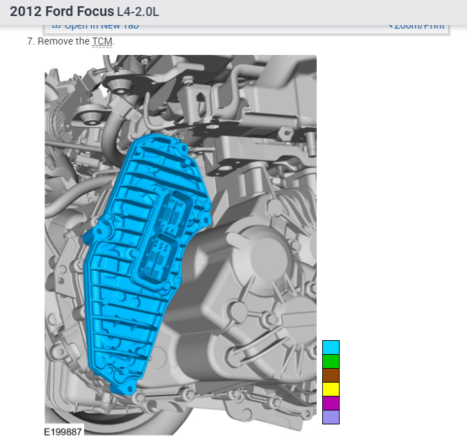

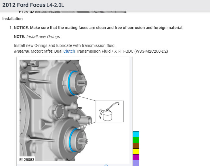

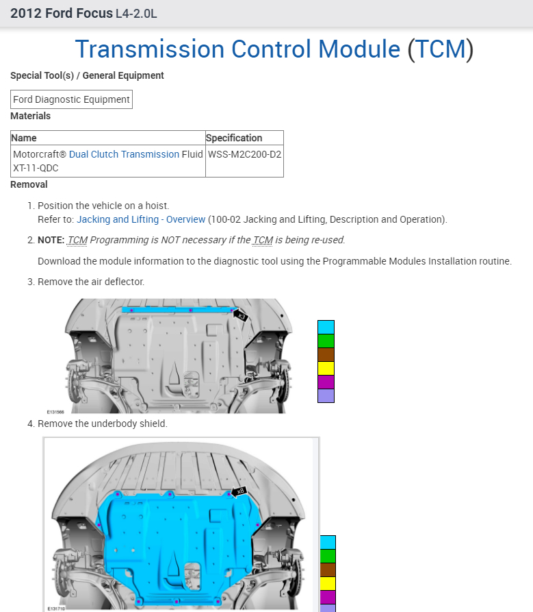

I need to know how to remove the TCM from my vehicle.
Jun 12, 2022 at 4:33 AM
SQM
  • 6,383 POSTS
The TCM needs to be accessed from the bottom of the vehicle by removing the slash shield.
Keep in mind that the new TCM will need to be programmed to the vehicle using an appropriate scan tool.
https://www.2carpros.com/articles/how-a-car-computer-works-pcm-ecm-bcm
I have attached the replacement procedure below.
Let me know of any questions.
