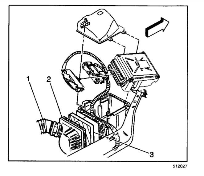

Where is the (TCM) Transmission Control Module located?
2001 PONTIAC GRAND PRIX
255,000 MILES • 3.1L • V6 • 2WD • AUTOMATIC
ED SIMMONS
Is it part of the ECM? please let me know.
Thank you
Jan 11, 2021 at 6:43 PM
Good morning,
The TCM is part of the engine control module.
It is located in the air filter assembly. I attached a picture and the procedure for you to view.
Service of the PCM should normally consist of either replacement of the PCM or EEPROM programming. If the diagnostic procedures call for PCM replacement, inspect the PCM first to see if the PCM is the correct part. If the PCM is faulty, remove the PCM and install the new service PCM.
The new service PCM will not be programmed. You must program the new PCM. DTC P0602 indicates the EEPROM is not programmed or has malfunctioned. There are no user serviceable parts in this PCM. The PCM should never be opened for any reason.
IMPORTANT: When replacing the production PCM with a service PCM (controller), transferring the broadcast code and production PCM number to the service PCM label is important. Do not record this information on the PCM cover. Transfer allows positive identification of PCM parts throughout the service life of the vehicle.
Removal Procedure
1. Disconnect the negative battery cable. Refer to Battery Negative Cable Disconnect/Connect Procedure in Engine Electrical.
2. Remove the left sheet metal diagonal brace. Refer to Brace Replacement - Sheet Metal Diagonal in Body Front End.
3. Remove the air cleaner intake duct (1).
4. Remove the air cleaner assembly cover and lift the PCM from the assembly.
5. Disconnect the harness connectors from the PCM.
6. Remove the PCM from the engine compartment.
