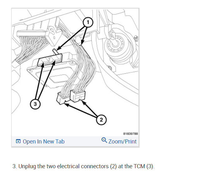

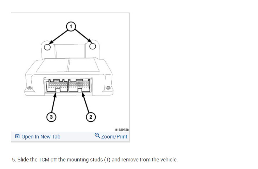

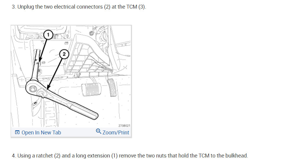

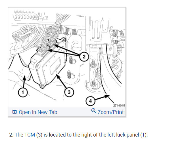

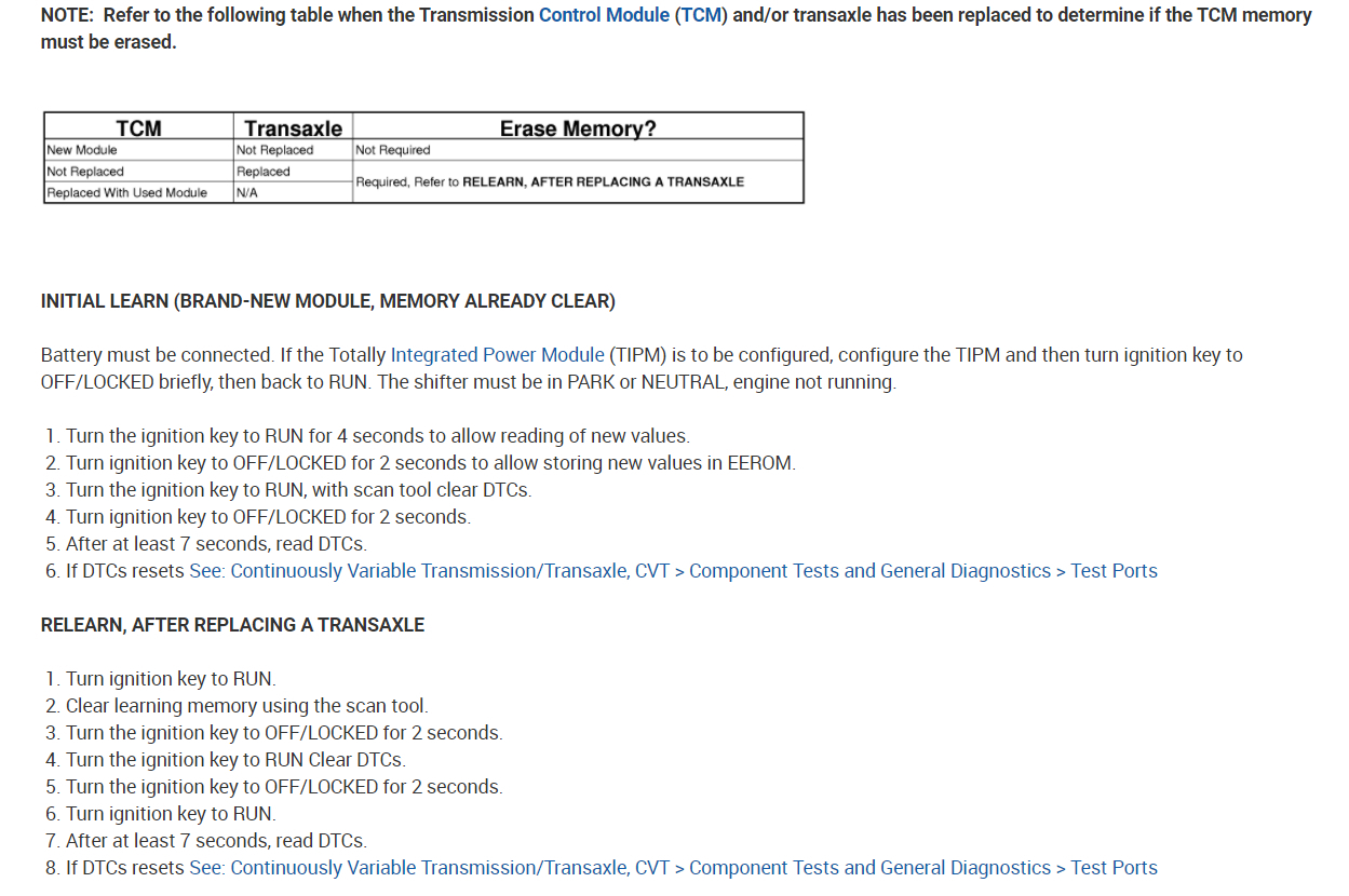

Where is the TCM located?
2011 DODGE CALIBER
150,000 MILES • 2.0L • 4 CYL • 2WD • AUTOMATIC
RICKY MASHAW
Location of TCM.
Apr 8, 2021 at 4:31 AM
Good afternoon,
I posted the location and procedure for you below along with the relearn procedure.
