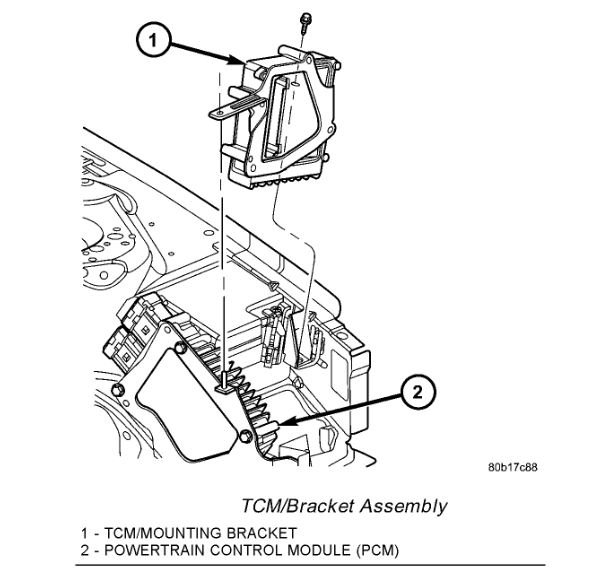

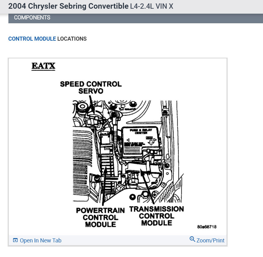

Where is the transmission control module located on my car (convertible)? Is there a picture pointing to it?
Jan 30, 2019 at 9:17 AM
The TCM is out by the right headlight on some looks at the diagrams below. Check out the diagrams (Below). Please let us know if you need anything else to get the problem fixed.
Jan 30, 2019 at 9:41 AM

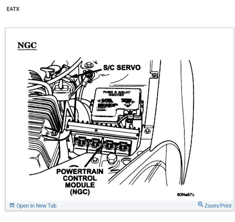

JREICHARDT
Thanks. The car I'm looking at has front end damage, and the TCM is not there, and there is no lose harness. This picture looks a lot like my 2002 though. If you are sure this is a picture from a 2004 then I'm at a loss? Thanks
Jan 30, 2019 at 9:49 PM
Yes. That is directly from Alldata.
