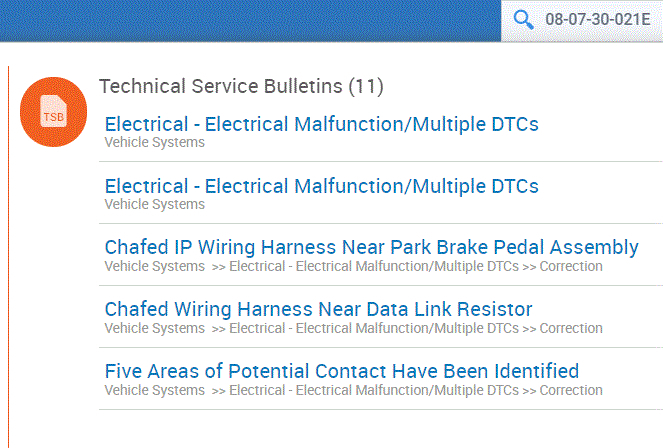

I have a transfer case with 15 codes that come right back after clearing. A couple communication ones that I will look at first. I found a bulletin for that (08-07-30-021E).

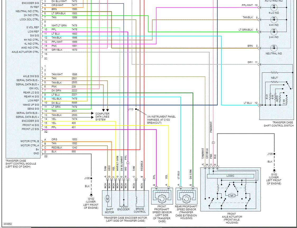

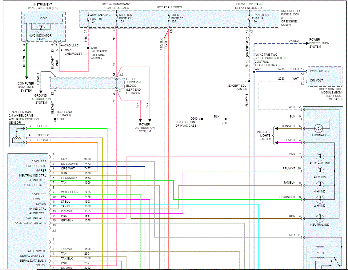

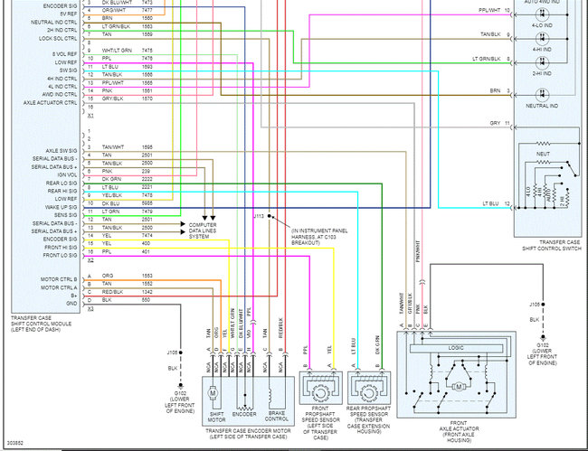

I am looking for the wiring schematics for this vehicle.

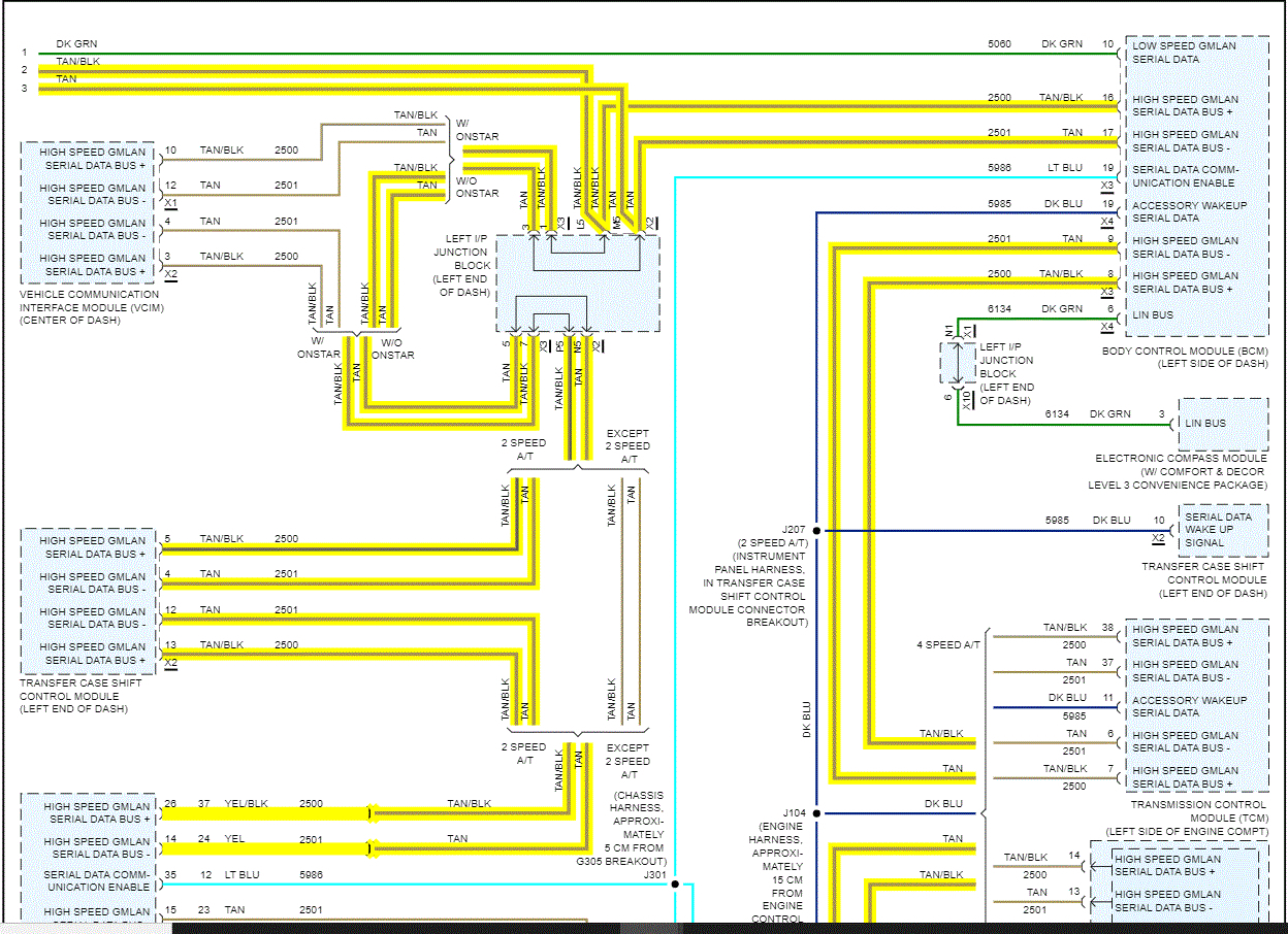

If you let me know the codes you found, I may be able to help. There are a few issues falling under TSB's that are related to wiring problems when I look up the TSB you mentioned. If you look at pic 1, see if you feel if any of these may benefit you.

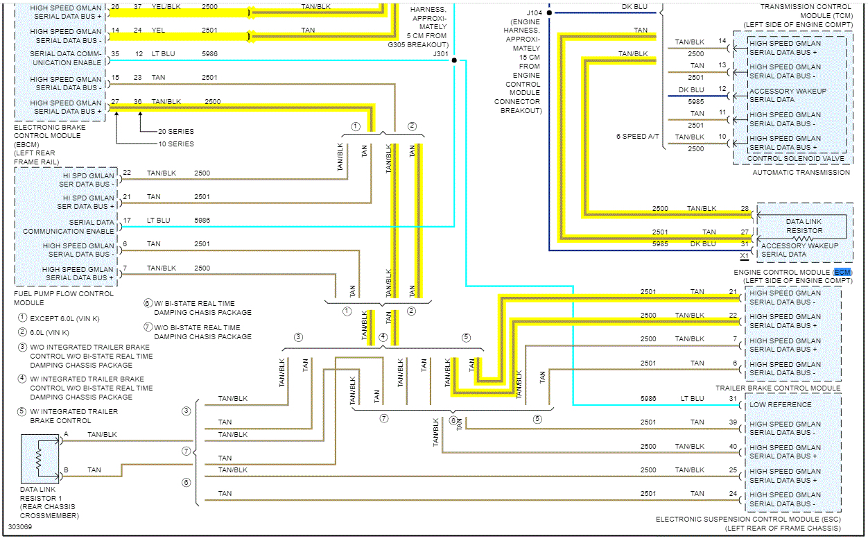

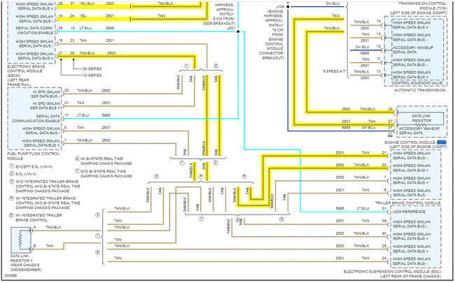

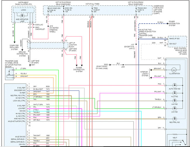

The remaining two pics are the wiring schematic you requested. I had to cut it in half to make it readable, but I did overlap them so you can follow from one to the next.

These are what are in it currently. Sure looks like the chaffing bulletins might help. The 4wd indicator works, at least the lights change, and it does go into 4wd lo, it just stays in 2wd.

The one code that sticks out to me the most is the U0073 71. That indicates a problem in the ECU high-speed bus communication which inhibits the setting of all other communication DTCs.
The idea of 2wd low range is tied into the front system codes. I suspect we need to check the can.

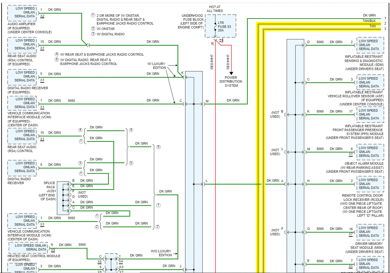

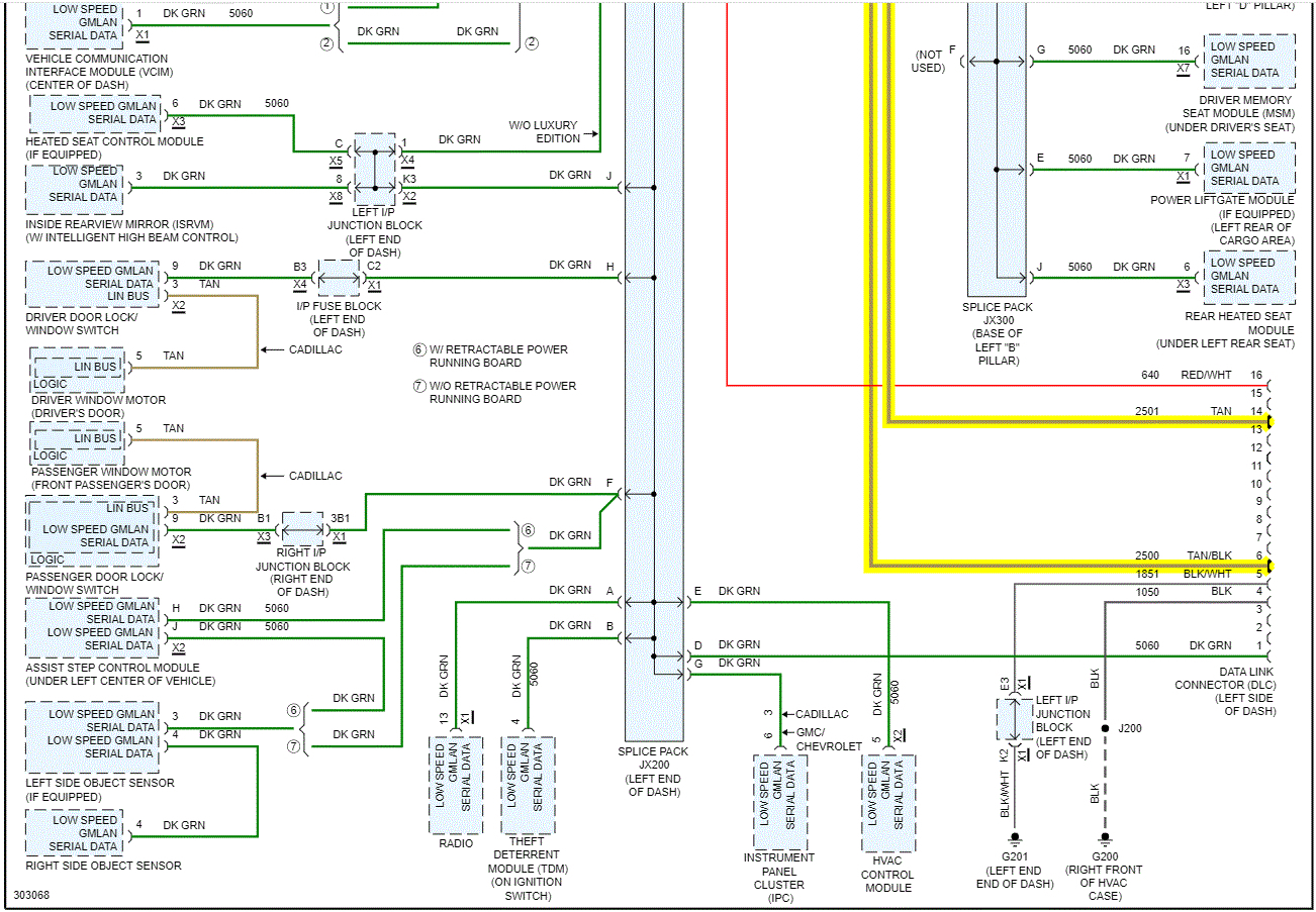

I attached the wiring schematic of the information bus. The system contains a few wires that run between computers/modules. The primary wire colors related to the transfer case control module are tan and tan wire with a black tracer. I would start at the TCCM. Inspect the connectors at those wires for damage.
Note: The TCCM is located under the dash on the left side which is where wiring damage has been identified in the TSB.
Let me know what you find.

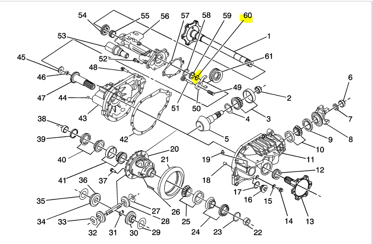

Yes, the scanner is looking at something incorrectly. I returned the first one and got their higher level one and it does the same thing. I am getting O2 response codes without the vehicle even moving and those need a cruise for a while to set.
On another note, the washer fix did not last. It looks like the clip is worn enough it won't hold and the axle is coming out again. I haven't torn it down again. Do you know the GM PN for that clip on the right front stub shaft?
Feb 3, 2022 at 11:34 AM
  • 110,194 POSTS
Are you referring to the output snap ring? Take a look at pic 1 below. If that is what you are referring to, look up GM part number 30026-06097523
Tell me if that looks like the snap ring you are referring to.
See pic below.

That is but the number you gave is an AC Delco part number. Do you know the GM one? It would only be 8 digits.
