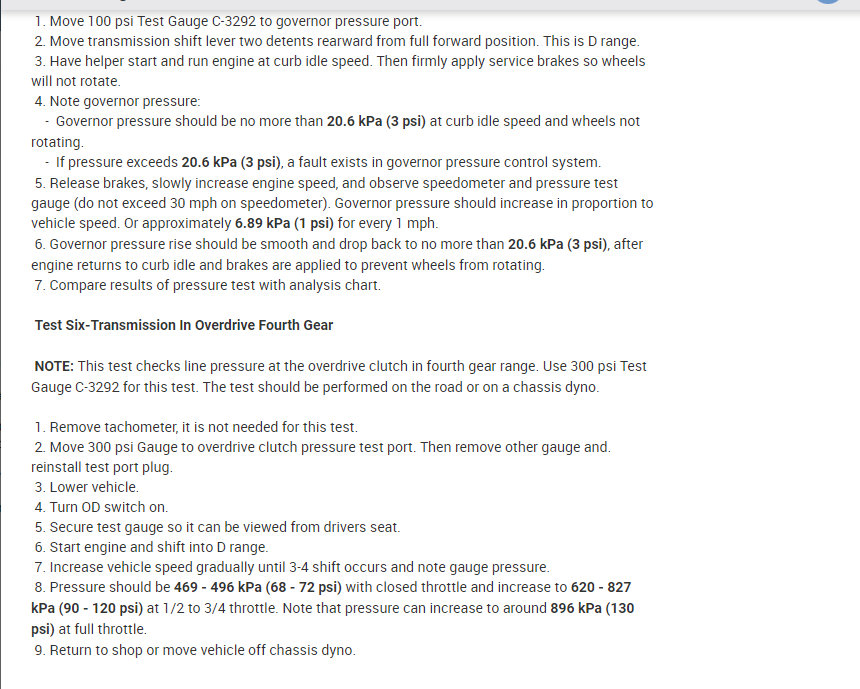

The gurgling noise that you are hearing is the fluid passages that have air in them.

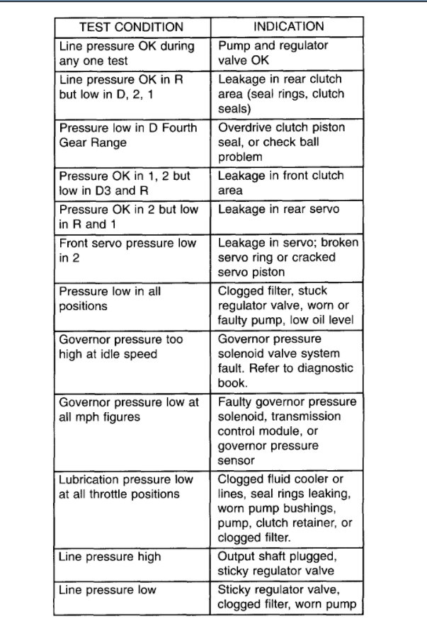

Based on everything you have done; I suspect this is due to a leaking seal in the transmission. The giveaway for this is that it seems fine until it gets warm. This is normally due to the fluid heats up the seals and they start leaking when the unit it worn out.

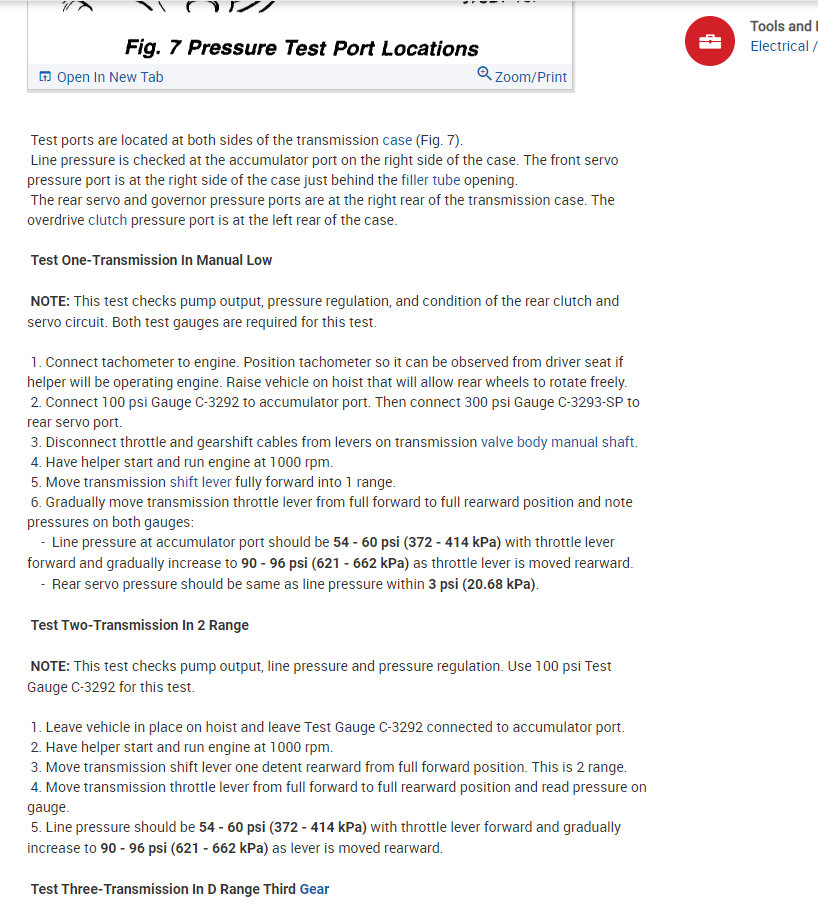

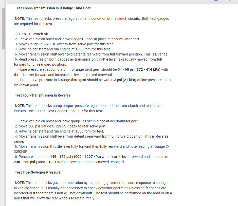

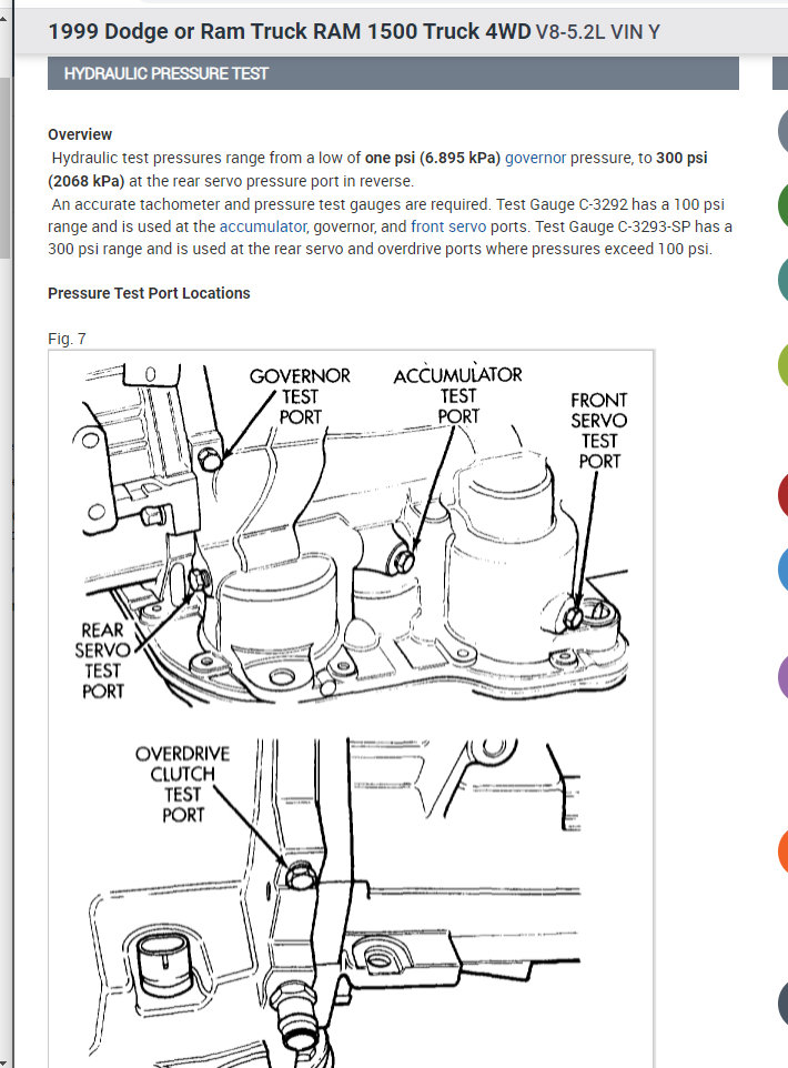

The next step is to check the pressure of the unit.
I am attaching the entire process below on how to do this.
Thanks
