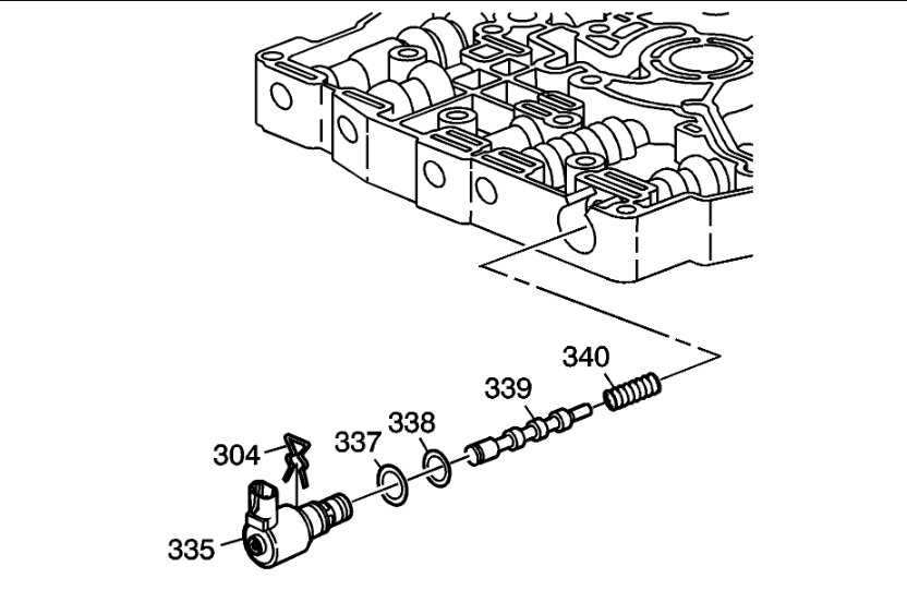

Where is the TCC control solenoid valve control circuit low voltage?
2009 CHEVROLET COBALT
200,000 MILES • 4 CYL • 2WD • AUTOMATIC
TLB76
Is it in the transmission or the outside, is it easy for me to do or get a mechanic to change it?
Sep 24, 2023 at 5:13 PM
  • 110,194 POSTS

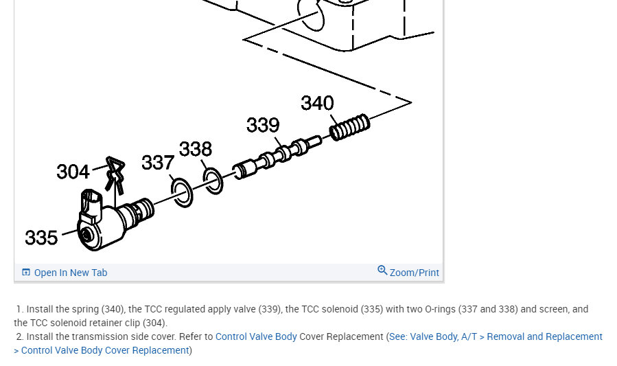

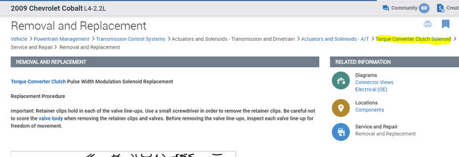

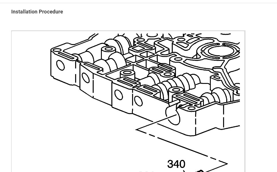

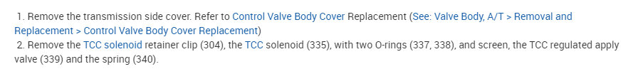

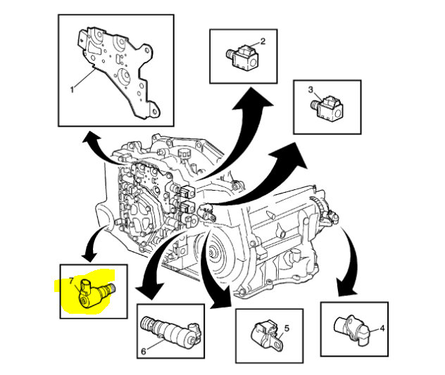

The part is in the transmission. To access it, the side cover (valve body cover) needs to be removed.

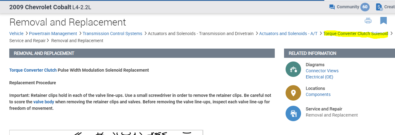

If you look below, pic 1 shows the location. The remaining pictures are the directions for the removal and installation of the part.

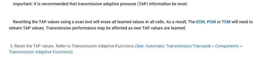

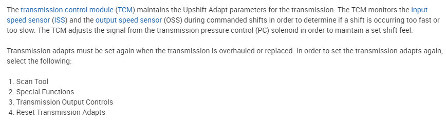

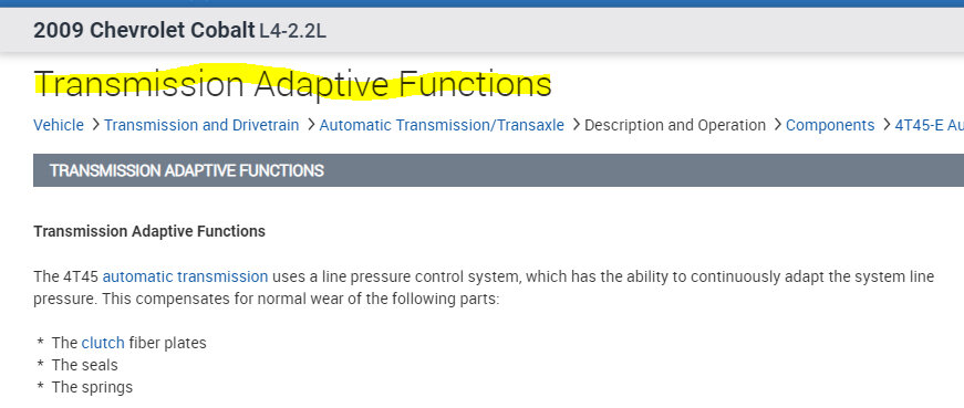

The last two pictures are for resetting the transmission adaptive functions.
