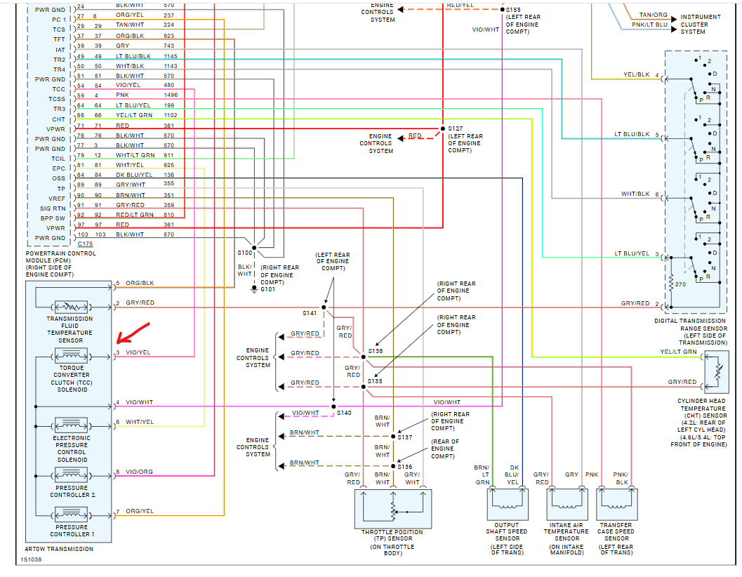

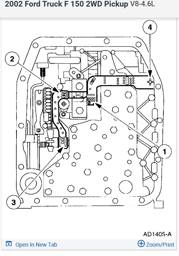

Where is the TCC located?
2002 FORD F-150
63,000 MILES • 4.5L • V8 • 2WD • AUTOMATIC
DREDRE702
  • 6 POSTS
Can't find the location of the torque converter control solenoid.
Mar 7, 2025 at 4:31 AM
  • 55,433 POSTS

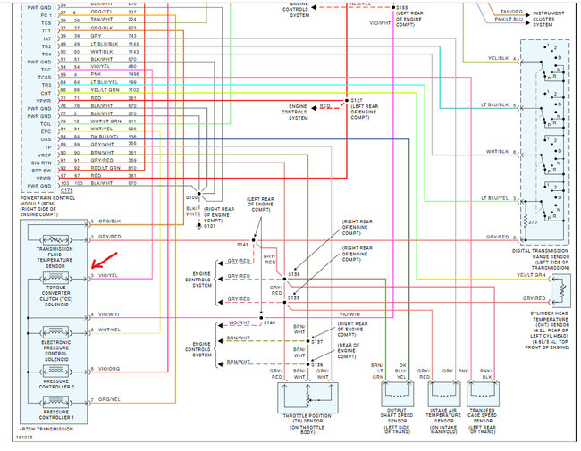

The torque converter control solenoid is on the valve body with the vio/yel wire. You should remove the pan and trace the wire to the solenoid in question. Check out the images (below). Let us know if you need anything else.
