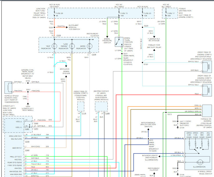

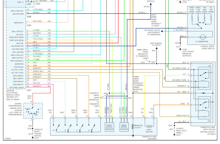

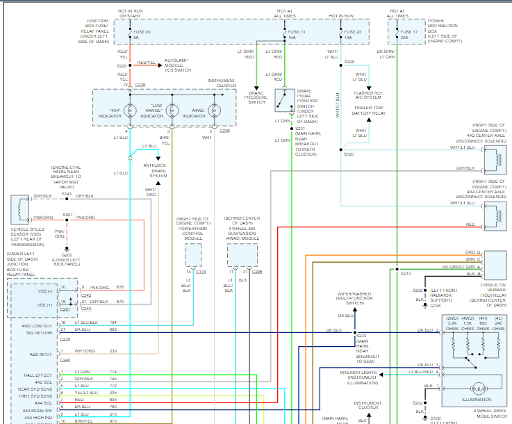

I am in need of a transfer case actuator plug wiring diagram so I know where the wires go in the connector.

I've attached the transfer case wiring diagram below as you requested. I've split it in half to make it larger in size by making it 2 photos. Hope this helps and thanks for using 2CarPros.
