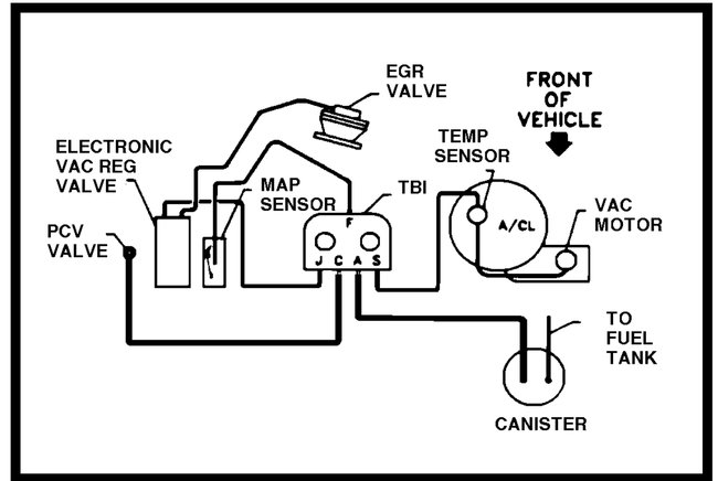

Vacuum routing diagram.

Here is the engine vacuum diagram you requested.

Thanks Ken.
