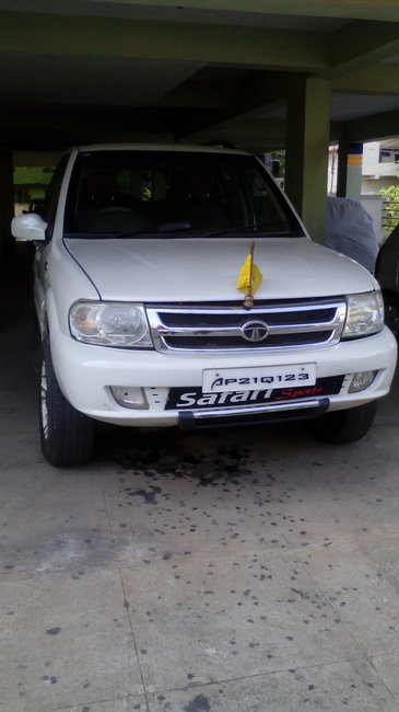

tata safari dicor 2007 model recently done by bore but vehicle pickup is slow acclator apply but pickup is not much suddenly slowly the speed recently lot of smoke come to my silencer

Heavy smoke and engine noice

Black or blue smoke and has a comp test been done?

VENNUANGEL
Black sir

black smoke is over fueling, is it a diesel, if so make sure that the pump timing has been set correctly. it should be set using a special tool to set the spill timing correctly.

VENNUANGEL
Bottom engine oil leaked color is black some one mechanic said it is turbo pipe leaked my self ask to turbo mechanic he said it is not leaked to turbo pipe

Wash down and run engine may be oil cooler line leaking, you should be able to see any leak easily,
