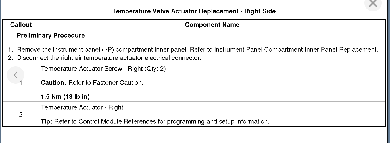

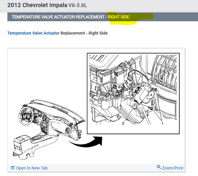

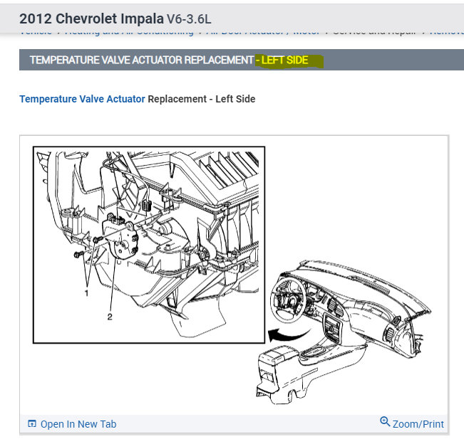

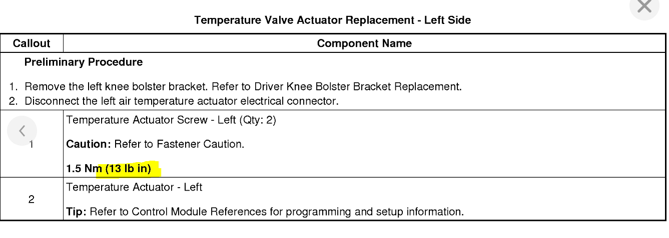

I can feel the blend door actuator tapping through my finger when I touch it. And I would like the torque specs for the drain plug and the actuators procedure.
Aug 16, 2022 at 1:04 PM
  • 110,240 POSTS
To get you started, here is a link that explains in general how one is replaced. You can use this to help guide you:
I'm not sure if it is the blend door actuator for the left or right, so I attached directions for both. The torque specs are included.
Also, when you say drain plug, I still don't know which one you are referring to. Let me know.
Take care and let me know if this helps.

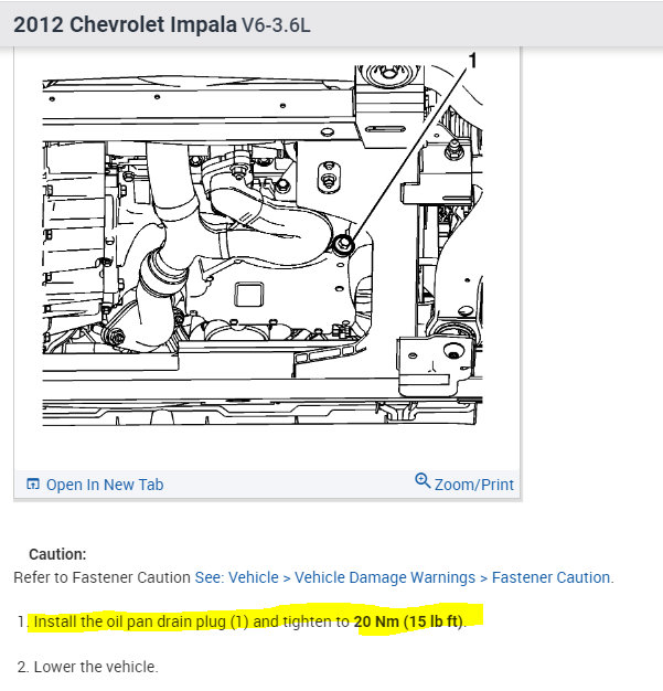

The oil drain plug specification and when putting gasket on does it matter how it goes?
Aug 16, 2022 at 7:58 PM
  • 110,240 POSTS
I attached the information below for the drain plug. As far as the drain plug, it shouldn't matter which way you install it. Most gaskets are plastic or fiber. If you have something different, let me know.

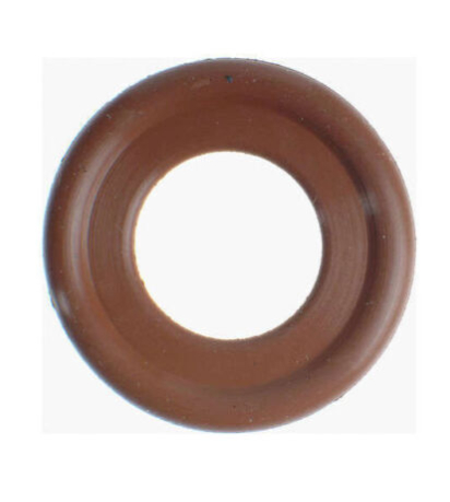

It's the Fel-Pro rubber dished washer.
Aug 18, 2022 at 5:54 AM
  • 110,240 POSTS
If it looks like the one, I attached, face the flat surface toward the pan. Also, if it is rubber, lubricate both sides with motor oil to prevent damage to the rubber.
See pic below.
Aug 18, 2022 at 12:37 PM
SKOOTER24
  • 275 POSTS
Why does one side have the dish look?
Aug 18, 2022 at 1:17 PM
  • 110,240 POSTS
That really just fits to the pan bolt. Did I have the correct type that I sent a picture of?
Aug 18, 2022 at 3:00 PM
SKOOTER24
  • 275 POSTS
Yes, that's the one.
