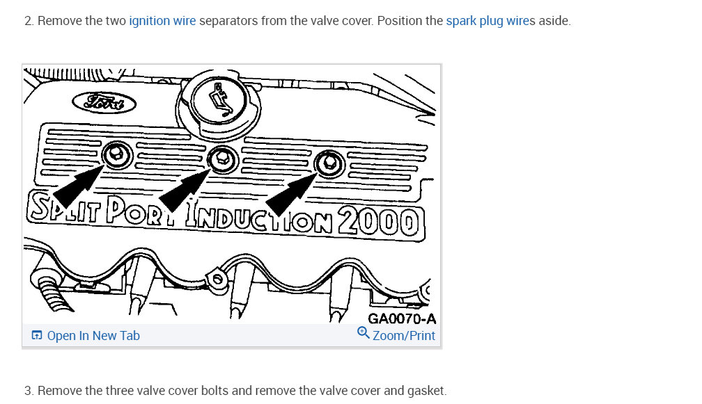

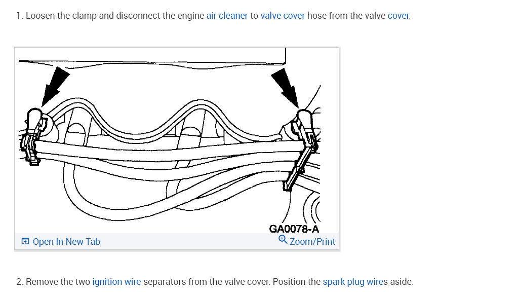

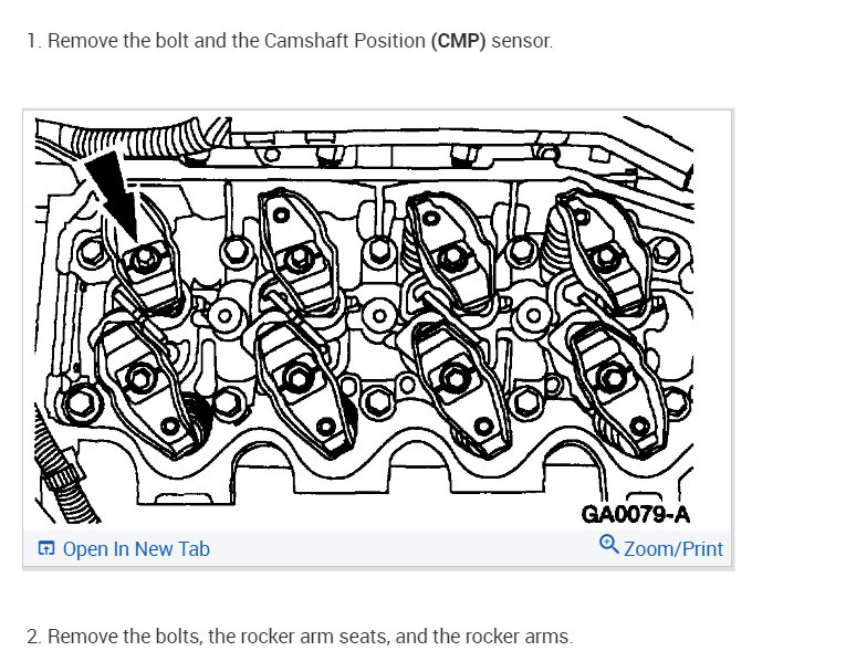

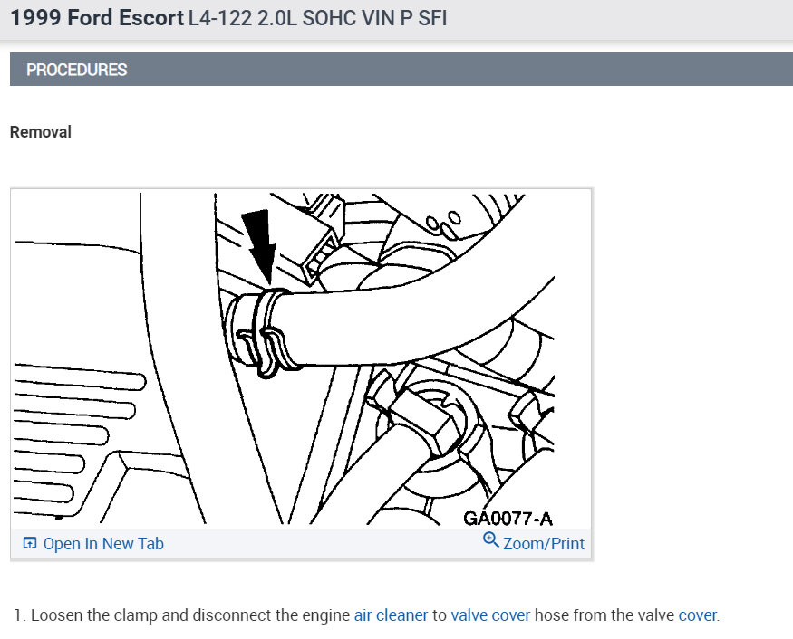

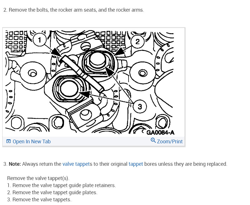

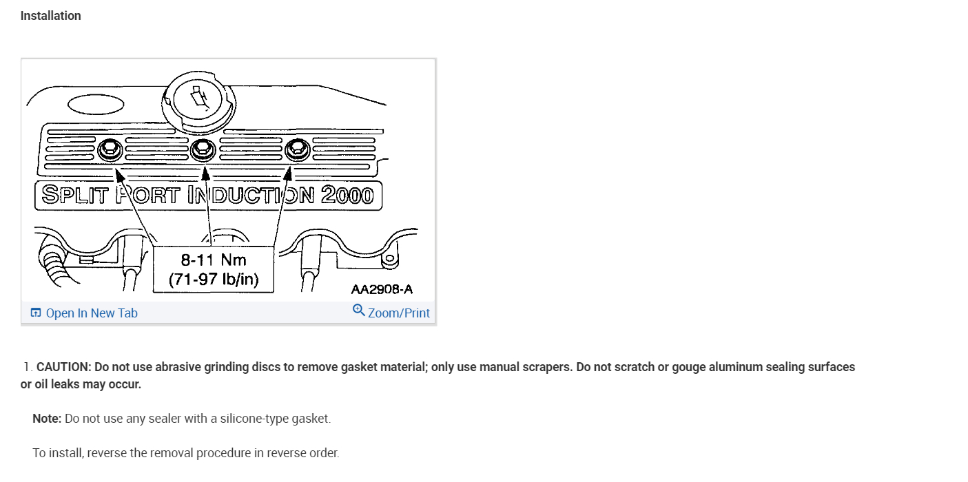

It sounds like you have a roller follower for the camshaft that has come apart but to be sure can you please shoot a quick video with your phone so I can hear the noise? that way I can tell for sure what's going on. You can upload it here with your response.
Here is how to remove the valve cover to looks for camshaft and roller rocker damage:
