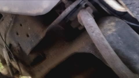

My vehicle listed above makes a tapping noise when started up and when accelerating, what causes this and is it something that can be fixed?

It sounds like you have an exhaust leak or a loose spark plug. Can you please upload a short video from your phone of the noise from under the hood so I can tell for sure?

I wanted to let the Mechanic know I just found out from the lady I bought my vehicle from that the oil hasn't been changed in 2 years. I know that's not good could that be what's causing the tapping noise?

Yes, I would change the oil and have a new filter, if this does not help it sounds like you have a roller follower or timing chain, that is the problem.

Got the oil changed and when I first started it up there was no tapping noise but after it was running for, I'm going to say maybe 2 minutes it started tapping again.

You probably have a worn timing chain or guide that has broken, that is what happened to the engine in the video.
