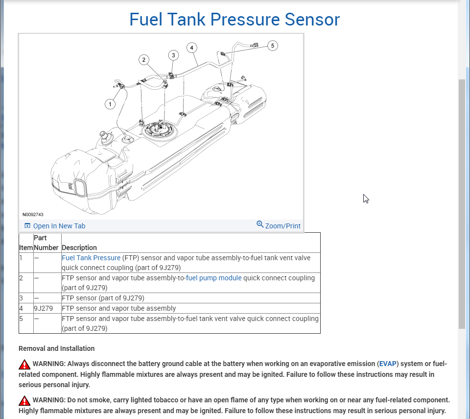

location of fuel tank pressure sensor is it in tank or where?
Jun 4, 2020 at 2:14 AM

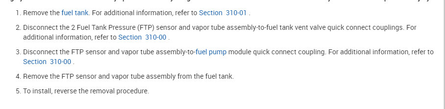

I attached the info on how to replace the FTPS. It is part of the line assembly on top of the tank. Let me know if you need more info. Check out the diagrams (Below). Please let us know if you need anything else to get the problem fixed. Thanks
